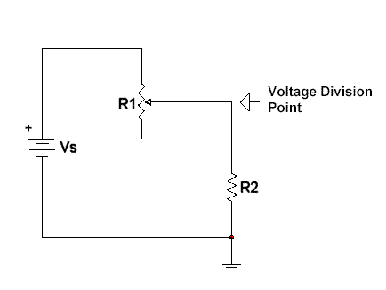

Hi ,how can I use a potentiometer as a voltage dividor "RHEOSTAT" ??
Where will the voltate be divided and how can I measure that by the voltameter...................

Here use this: The voltage at that point is equal to
Vs * (R2)
(R1+R2)
since you want adjustable do the calculation for the lowest and highest values of R1 for the range

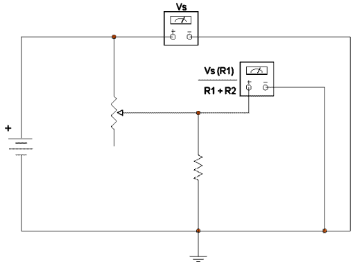

and ...
measure voltage 1 from battery + to the center tap of the variable,
measure voltage 2 from the center tap of the variable to the battery -
Thanks,but if I put any resistor instead of the potentiometer in ur circuit it would divide the voltage too in the same way...so what's so special about the rheostat other than the adjustable value?

here ya go:

Resistors are available in standard values such as 100 ohm and 220 ohm plus they have some variablity unless you buy precision. To get the voltage you want you may need some oddball resistance such as 275 or something. You may have to put a few resistors in parallel or series to come close to the needed value or, you find a potentiometer with an appropriate range and you can adjust it to get the voltage you need
and there is one more thing. resistors, in general, unless you use ceramic, support small amount of power dissipated on them, so they are not good for large currents.
if i remember well, a rheostat is usually a large resistor, wich can support currents from 1-2A up to 10-15A or even more. plus they are large and heavy.
a potentiometer is basicly a smaller rheostat.
