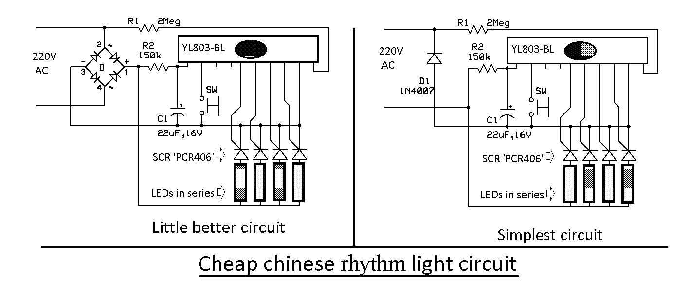

I have many many such devices (attached circuit) but all are damaged. There's a delicate chip (it should be) inside but it's being operated with horrible supply- just a diode and a resistor. I think the main reason of the damage is surge voltage during ON or OFF or sparking on switch or on plug.
I am thinking to fix it with pretty nice regulated and reliable circuit. I think if the IC gets totally safe supply, it would survive till many decades! IC prefix are different like- B-803A, YL 803, XX803, Q803 etc but all are same. Datasheet is not available (I didn't find easily).
Main questions are:
- First thing I decided to add a zener diode of 4.7V across C1 capacitor. I measured 3.7V across the C1 (22uF) while the device was operating. And decided to add another 3.3V zener from 10th pin to 9th pin. (Voltage across 10th pin to 9th pin was 2V while operating.) It is just to block high surge voltage from resistor.
-Second, I am thinking to use a safe SMPS (like 220V AC to 3.7V DC or etc) to supply the IC. But one thing is confusing me- Look at the 2Meg resistor. The supply for 10th pin has taken directly from AC line, but why? (10th pin has +2V, referenced to 9th pin). Maybe the IC takes 'clock frequency' of 50Hz from the mains. If so then I cannot feed just 2V there in the 10th pin from SMPS. What you think?

I have had a slightly longer look at your circuit now and have a better understanding of the design. From the SCR data sheet I now know that the LEDs can't be high power, but if you could let me know roughly what the LED current are, that would help.
Here are my second thoughts:
(1) You may be surprised, but the original 'simplest circuit' (SC) is better for this application. While the diode bridge will half the ripple across C1, it does mean that the bottom of C1, effectively system OV, will have a square wave on it of 600mv to -600mV with respect to the neutral line of the mains supply. This is generated by the forward drop of diodes 3/4 and 2/4 and won't stop the circuit from working but it is undesirable. While the ripple is double with the SC, it should be fine for this circuit and it eliminates three diodes involved with the mains so it reduces cost, increases reliability and increases safety.
Apart from the above, I can't see any problems with either power supply arrangements that would allow mains voltage spikes to cause a malfunction or damage the chip. In fact, both approaches give exceptional protection. I now would advise to stay with the power supply arrangements of SC, in spite of what I said previously about using an off-line SMPS.
Your idea of putting a 4V7 Zener diode across C1 is spot on and is a good precaution in case the voltage across C1 tried to rise too high. A ceramic capacitor, or other high frequency type, across C1, would be another good idea. 100nF would be ideal but any value above 10nF would be fine.
(2) The clock arrangement is a worry. As the clock input is derived from the mains via a 2M2 resistor, it is feeding a +-141uA (311V peak/2M2M Ohms) peak constant AC current into the chip clock input. In theory this may be OK, but without the data sheet for the chip I can't say if the substrate diodes will take this or not- unlikely. In any event, it is very bad practice. But don't worry the solution is straight forward. Sorry to say, that putting a capacitor between the chip clock pin and 0V could make things worse, but you were looking in the right area.
(3) The outputs from the chip to the SCRs, and the SCRs themselves also look vulnerable. I'm still considering this area.

Totally agree with the Zener. You might add a ZNR for the mains.

Do you thing it's also good idea to add a zener diode from 2Meg to Gnd? (Lets say Gnd is negative lead of C1).
With bridge diode circuit, I got the LEDs were getting so bright and hot. Maybe because of full cycle. Then I used 2nd 'simplest circuit' where there's just a diode for half cycle rectify and then I got average light from LEDs and got not so hot.
I think another place of damage the IC is gates of SCR. If SCR gets short, maybe IC gets high volts back from gate from shorted SCR, won't it?

That is correct; you will be putting twice as much average current through the LEDs with the bridge circuit. You are right: both halves of the mains supply sine wave.
I also found many of these SCRs are also being damage there. Some were Anode-Cathod shorted, some were open. Recently I replaced two of them and fixed one circuit.
That's what I was concerned about. As I said, I am thinking about a solution for you. But you could try putting 100 Ohm resistors between the outputs of the chip and the trigger inputs of the SCRs. I'm suspicious about C1. Please check it is connected OK: no broken traces or bad solder joints. Perhaps change it anyway. I think any value will do, from 22uF upwards.
Afraid not. That would probably do nothing unless you knew the exact characteristics of the clock input when you could use precisely the right value zener. Even then it would not be a solid solution as the supply line for the chip is ill defined.

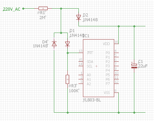

Hi Willen,
Clock input shaping and protection for you:
D1 is just 1N4148 like the other diodes. The symbol for the chip is not correct, but the schematic shows the idea.

In the modified circuit, whole circuit is supplied by a 2M resistors. Then I think the IC gets just few hundreds uA current, which might be insufficient, isn't it? Do you want to modify for better protection?
Snubbers (an RC network) might help, across the SCR. I'd try 0.1 uf and 100 ohms.
Thank you KISS that I learned to add snubber across the SCR to block overshoot voltage across the SCR during OFF time.
-Voltage rating of the 0.1uF?
-Will the snubber discharges the overshoot voltage and protects SCR?
:) Hi Willen,
Perhaps I should have made the schematic clearer.
I'm suggesting that the 3 diodes and resistor are added to the original circuit.
C1 is the C1 on the original circuit and R1 is also the R1 on the original circuit.
The power for the IC is as before, that is the voltage across C1. I have had a look at a similar data sheet for the IC by using the link you provided; The supply voltage should not exceed 5V, so your idea of connecting a 4V7 zener across C1 is not only a good idea, but essential.
