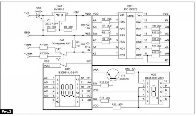

Help to convert to Anode Display for a 50 V DC Panel Meter...
Hello All
I got this code from internet. Its a good volt meter circuit, I tested. Simple and Locally avilable components. But the code for the Common Cathod Display. Can you someone help to convert it to Common Anode?
And this is the code...

Thanking you ....

I just success in compilation only. But its only common cathod. its working good.
But I need to do with common Anode display. I try much times..
I just change to -
       retlw   b'11101011'   ;   ( b'00010100' ; for 1 : this is the original code)
[code end]
I just invert all binary number like that...
But nothing in the display (display OFF.
any other change I can do?
schematic?
I just invert the avmeter.asm and avmeter.h files. (Invert all the binary number. is it okey or can I do change in the opcode too?
The schematic helps a lot... Thank you.
I believe these are the relevant code sections for the 3-digit display;

Quite a few changes are necessary. I have not looked at the single digit LED 'A' / 'V' display, yet. More later...
Cheerful regards, Mike
Here's my untested first attempt (below). Caveat... There may be errors... I have not had a chance to see if it even assembles correctly.
All of the changes are in the "DISPLAY" section (the two LED segment tables are unchanged).
More later. Mike...
