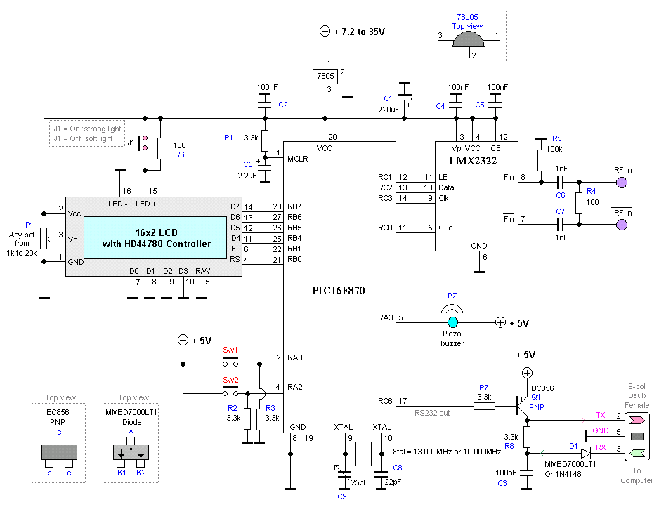

Dear All,
i got this freq counter from internet and i want to developed my own software. The schematic is attach and the url is https://hem.passagen.se/communication/fcntlcd.html
This f counter used pll ic from national (lmx2346) and capable to measure freq up to 2.5 Ghz. This ic used to divided freq input by 64 and programmed by spi interface by microcontroller. The freq input will change the charge pump, its ttl leveler. This charge pump (Cpo) will directly connected to microcontroller and measured the freq by microcontroller.
I got no problem to interface lcd, and programmed pll ic with this microcontroller.
The problem is i don't know how to start to measure the freq was converted to charge and connected to RC0 of microcontroller.
Any idea will aprreciated.

Your post is confusing. The webpage and your GIF image indicate a LMX2322 is being used. If this is the case, then:
First you need to get the datasheet of the LMX2322 here:
Look carefully at the wording on page 9 section 2.2.2 of the datasheet, which I quoted below:
If test mode is ACTIVATED (R[14]=1), the outputs of the N and R counters are directed to the CPo output to
allow for testing. The PD_POL bit selects which counter output according to Table 2.2.3.
The charge pump output(CPo) of the LMX2322 is thus not used in the usual analogue way but the designer places the LMX2322 into test mode, so that the output of the N counter is available at this pin instead. By measuring frequency at this pin, one can obtaine the divided down input frequency.
*** If however, the LMX2346 chip is what you have on hand, then you can program the LMX2346 internal register control word so that the LD pin can be used to output the divided-down frequency signal of either the N or R counter.
Hope this helps.
Edited: added info on LMX2346
yes you right i want to develop using lmx2346 cause that's only i have on hand.
By the way thank you for the info, you've give me a light :) so i know where to start.
Here's my list that i want to do with the software:
1. Initialize lcd
2. Set the pll through microwire
- Program N Divider to 64
- Set LD Output Select (Register R 14:13) so N Divider will output to LD Pin
4. Measure freq on pin LD
5. Display freq on LCD with real Freq = freq x 64
6. Loop to routine 4 every 1 second
7. End
Is it right?

That sounds about right.
Don't forget to initialize the PIC timers too. You'll need them to provide a fixed time interval for frequency measurement.

First it puts the chip in TEST mode with N divider as output, then sets the B counter to 2, and A counter to 0.
Altough the datasheet stetes several times, that the minimum value for B is 3, it seems to work.
NOTES: Divide ratio: 3 to 1,023(Divide ratios less than 3 are prohibited)

SET_TRIS_A(0x18);
disable_interrupts ( GLOBAL );
setup_timer_0(RTCC_EXT_L_TO_H | RTCC_DIV_256);
enable_interrupts ( GLOBAL );
enable_interrupts (INT_RTCC);
set_timer0 (0);
delay_ms(100);
k = get_timer0();
output_low(PIN_A3);
k = get_timer0();
u_cnt = 0;
i = 0;
while (i == 0)
output_high(PIN_A3);
output_low(PIN_A3);
if (get_timer0() > k)
i = 1;
else
u_cnt++;
u_cnt = 0x100 - u_cnt;
u_cnt = ~ u_cnt;
u_cnt++;
result = (l*0x10000+k*0x100+u_cnt)*0xA;
result= result; //the result = +-8kHz :(
OK, the calculations are right, but I did not took into consideration that the TIMER1 in asynchronous counter mode (without prescaler) can handle signals up to ~16,6MHz (60ns period)
You should also use TIMER1 instead of TIMER0!
I'm using Timer0 on pic16F876 for freq counting (PIN_A4). I have config Timer0 to External clock mode (RTCC_EXT_L_TO_H) and enable iternal prescaler (/256). After 256*256 = 65536 clocks i have INTERRUPT...
Also i directly connect PIN_A3 to PIN_A4. After delay i sent level 0 to pin A3 for stop timer0.
This scheme work fine and can count freq up to 50Mhz, i will try use you calculation with 10Mhz oscilator. Also i will try use timer 1 in asynchronous counter mode.
Thank you for advise.
The author in his 2.5GHz counter doesn't use the Timer1 interrupt for measurement. He creates a 64ms delay loop, within he checks the TMR1IF flag, and increments a 1 byte counter. At the end, he copies the timer1 into 2 more registers, giving a 24bit (3byte) result.
The only interrupt used is the timer0 for display update, if I'm right.
Here: https://www.sprut.de/electronic/pic/projekte/frequenz/freq_uni_628.htm
you find another good frequency counter 2Hz-1GHz with source code. It has a nice autoranging feature, so it self adjusts the prescaler ratio (and thus the precision) with incoming frequency. I have found a U813BS 1.1GHz prescaler from an old TV's tuner. You could use the LMX2322 instead, and change to a higher pin-count processor to be able to program it.
By setting a too high prescaler (ex 256), the problem is, that you will get a minimum of 256Hz resolution. (1s gate time)
szabi, thank you again.
For precision count (resolution <256 Hz) I'm using a count up procedure.
After stoping of timer0 i send level 1 on PIN_A3 in cycle, while timer0 will increment.
The resolution in Hz = ~((256 - count of click on PIN_A3)+1).
For example - after stop we have 129 in timer 0
129*256 = 33024 Hz.
Then we use count up procedure... The value of timer0 will increment to 130 after 31 clicks.
256-31 = 225
~225 = 30
30+1 = 31 Hz.
Finally we have 33024+31 = 33055Hz
PS:
Sorry for my poor english.
