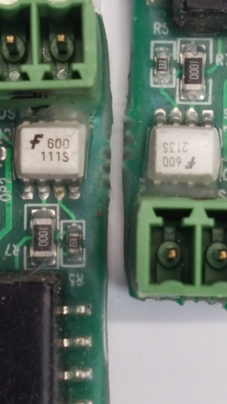

Help to identify 8 pin IC please
Western
Hi guys, I haven't been here in ages ... just wish I had more time to participate.
I am generally pretty successful in identifying unknown parts via google ... but am stomped with this one.
I have a number of boards to repair and one particular IC is giving me trouble.
One board has what appears to be a Fairchild IC marked with the logo and then "600" and "213S"
Second board has the same but "111S" in place of "213S"
On the remaining boards the ICs have a logo which I can not identify ... appears to be a white circle with nine vertical lines inside it ... though it is that hard to see that it could be a sine wave perhaps ... but fully contained inside the circle.
These are marked with "600" and "002".
Pin 5 is the supply - and pin 8 is 5 volts. Pin 3 is an input from a sensor of some type.
I'm sure it will be a piece of cake for someone ... but so far I've had no luck.
Thanks.

It looks (from the shape) like an optocoupler - does that seem likely from the context of the circuit? Some logic-output optos come in an 8-pin package.
the white device looks like an optocoupler. The F symbol indicates Fairchild Semiconductor (now ON semi)
Not sure about the other one
Thank you Tom and Simon. You gave me the impetus to search again and this time I was successful.
I searched for "fairchild 8 pin optocoupler 600" and checked images. There was an image of my part on the third row.
Turns out it is a HCPL0600 DC Input Logic Gate Output Optocoupler.
I'll add this to my hand drawn circuit and see if I can work out how the board functions.
Wish I had asked earlier ... could have saved a lot of time. :)
Thanks again, much appreciated.

It looks like the reference designator lettering near pin 1 (a common location) is OP2, again leading to an optocoupler of some type. However, that ref des might be for some other nearby component; a wider shot would help. The board was laid out using PADS software. The date code on other components where it is more obviously a date code might confirm that the 2nd line on your parts is the manufacturing date, leaving the first line as the clue to the full part number.
Often, an SMT optocoupler has an asymmetrical body, in that the plastic part above the separation line where the pins come out is thicker than the part below the pins. The black part in the 2nd photo looks like this. This is a way of increasing the "creepage distance", a factor in the part's voltage isolation rating and another clue as to the part's use.
Mmm ... I dropped the ball there. You are dead right, the OP2 does refer to the part ... there is an OP1 on the board as well and that is clearly an opto.
Now that I have the datasheet, the date codes are obvious too. Good reminders of other things to check when I'm stuck. Thank you very much.
