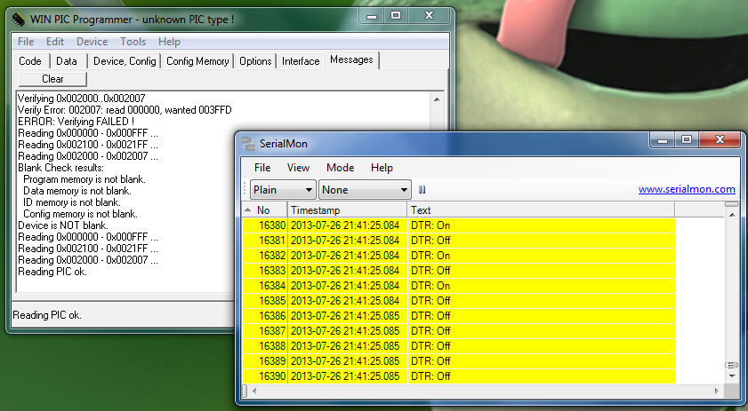

Tried it on the PC. Had to fiddle a bit, just tried testing with blank check and read since my test program is on the lappy. Looks okay.

I gave it a try as you suggested, but the version I'm using is the only one that controls the port properly. I also tried picpgm, which works sometimes.
I have just been testing the voltages on the dongle whilst sending data to the port. rts and dts only go to 3v, nothing seen at txd when sending a text using sscom32e, even though it shows up on serialmon. So I need buffers. Don't know what's going on with txd - good job I'm not using it!
this programmer from DL4YHF worked for many of us under WinXP. What is the pc (motherboard)/ latop and the OS you use ?
