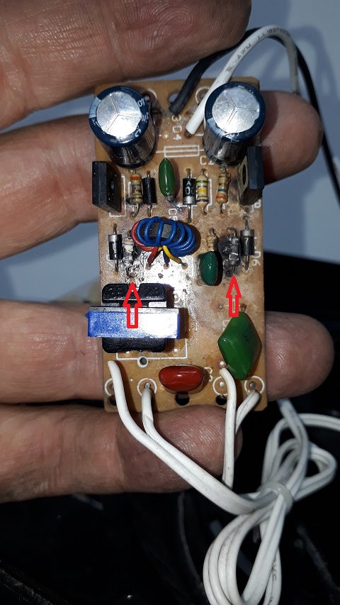

Hello, I have a ozone yc-928 facial steamer and it fell and had a short circuit. I am trying to repair it but there are two (2) resistors that are burned beyond recognition. I had the board cloned and need to know the reference to the resistors that were burned. Can anyone please help. Thank you.

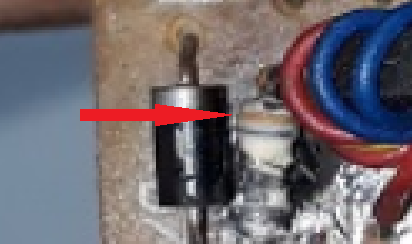

Just a qualified guess, but from the below enlargement:
that's a brown band (and logically, the next one is a green band and then probably a brown band).
So, it's a 150\( \Omega \), 1/2 or 1 W resistor (other side the same). A current limiter, most likely...
