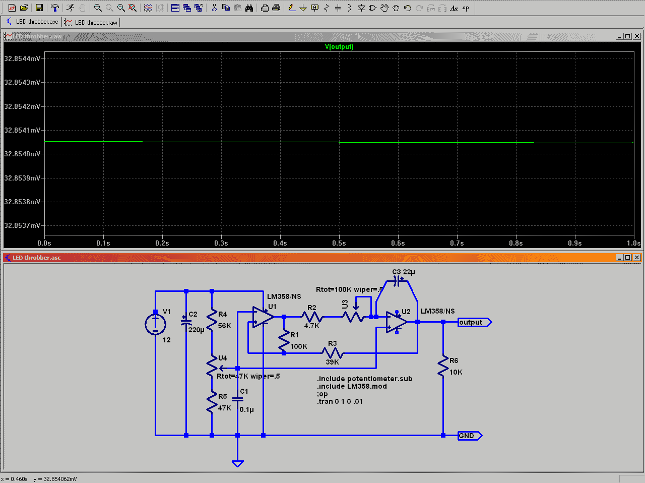

So I've got a circuit I want to simulate in LTspice, all set up and ready to go. I can run it, but I'm not getting the waveform I should be seeing (triangle wave).
I think there may be a problem with the op-amp model I'm using. I copied National Semi's model for the LM358, but I may have screwed it up: the symbol I inserted was a generic op amp ("opamp2"), and I gave LM358/NS (Nat'l.) as the value. Is this right?
It ran and gave me a flat waveform at the output until I connected U2 to power. Now it runs a bunch of iterations, very much slower, then gives an error message ("Singular matrix: check node u2:6 Iteration No. 1").
Isn't there some way to indicate that these 2 op-amps are in the same package, and only one of them needs power connections?

I was actually able to run this, stop it (with <Esc>) and see what looked like a believable waveform. If I let it run to completion, I get the error message indicated above.

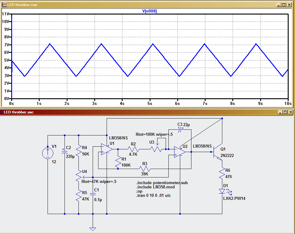

hi cz,
I would suggest when you post a LTS query that you post the asc file.
To have a dual LM358 model for LTS, which IMHO is a waste of time, you have to create a 'hierarchical' circuit...

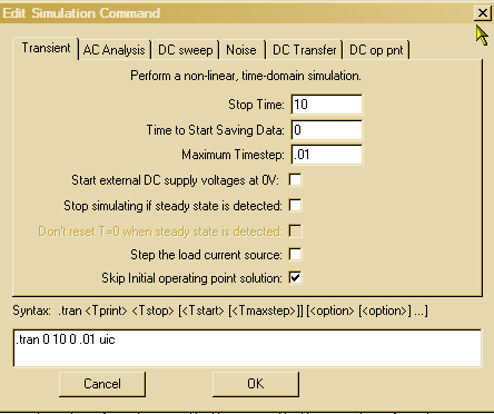

hi cz,
Your asc file runs OK for me.
BTW, if you want to cut down the simulation time click the box as shown in image #1
Skip initial op point.
EDIT:
The include potentiometer.sub command used the 'regular' sub from my hard drive.

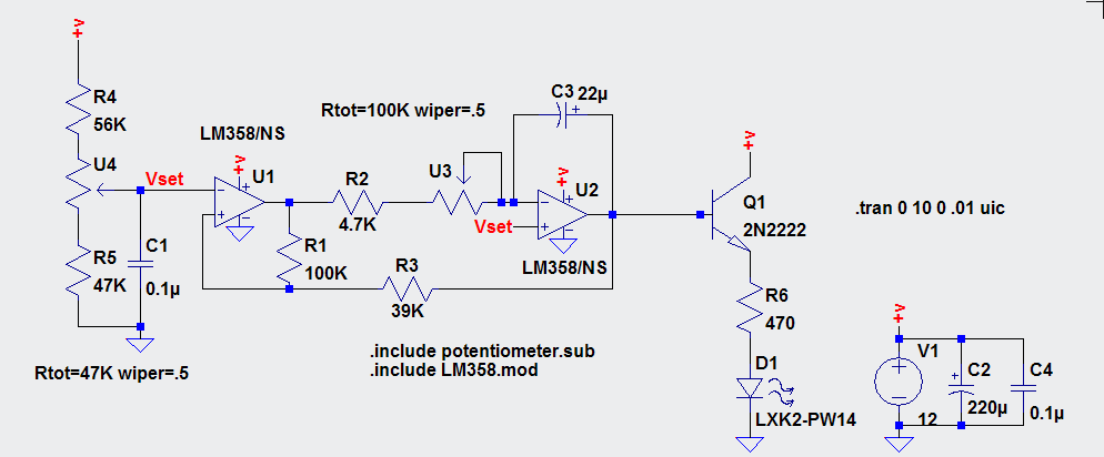

hi cz,
If you want your circuit to be less cluttered with connecting lines, use F4 key to assign a label to Nodes.

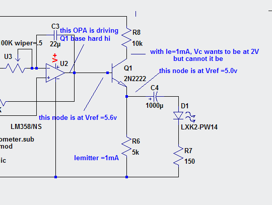

Here's a small puzzle: I made the following change to my circuit, adding a collector resistor to the Q (R8). As a result, the simulation slows down to a crawl and never completes. Is this a bug in the program? some topological situation it can't deal with? have I created a "forbidden" condition? Not a huge deal, just curious.

hi cz,
Basically there isnt a 'sane' solution for the circuit, consider how you have the output transistor configured.!

Look at this marked up image.
The LM358 output is high and has low impedance, so its forward biassing the transistor.
Allowing for a Vbe drop of 0.7V, means the emitter is at 5V, so with that 5K emitter resistor, means it passing 1mA.
The collector is connected to +12V via a 10K, so if 1mA did flow in the 10K, the collector voltage would be 2V, which it cannot be as the emitter is at 5v.
So LTS is trying an impossible calculation, you try it with pencil and paper, lets know what you get...
