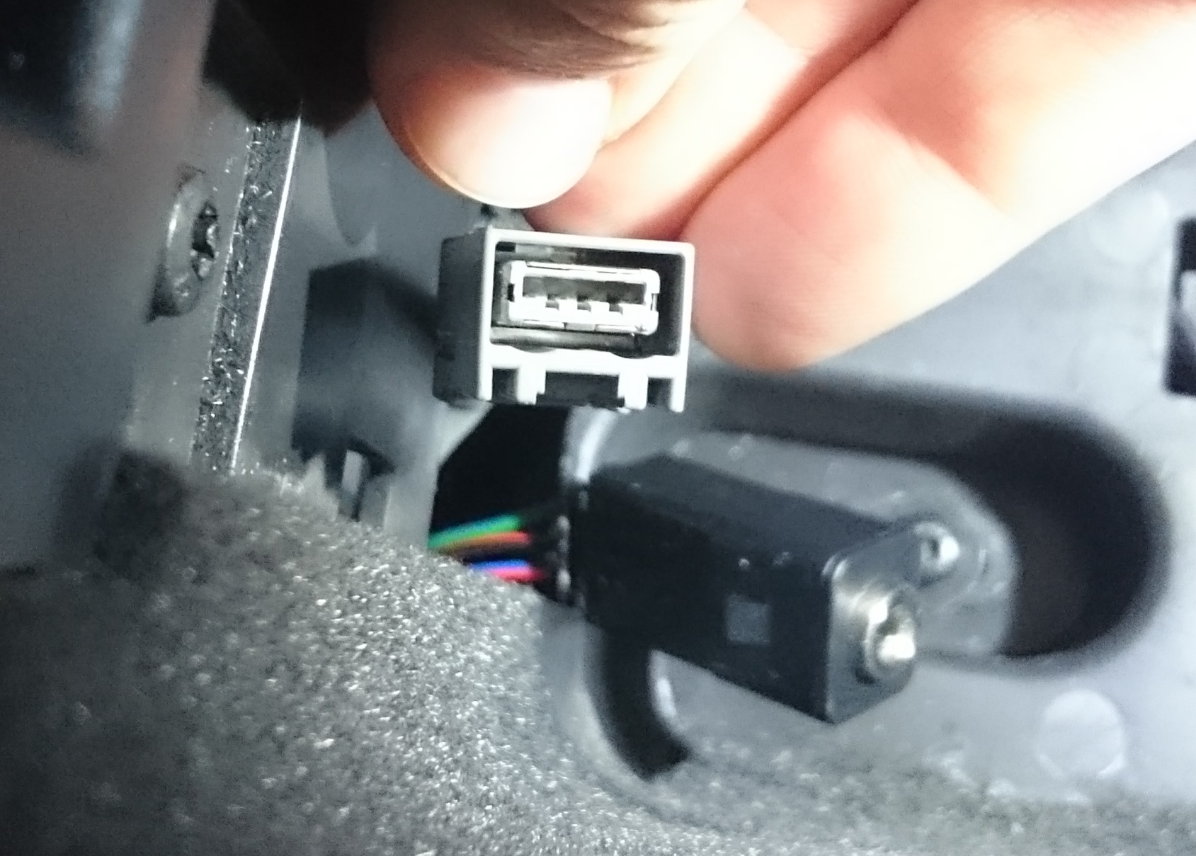

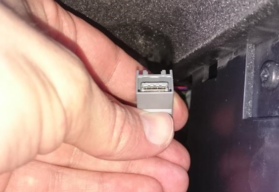

Hello to everyone,
I have recently booth a used Volvo S40 2011 and the car audio system comes equiped with an AUX & USB option.
The jack connectors for the AUX is fine and work ok, but the one for USB is very strange.
After removing all unnecessary covers I had reach the connectors due to the fact that no USB < female, male, slim> could fit inside this connector.
Does anyone has any ideea what kind of jack connector is this one?

Looks like a standard USB connector. Did you try flipping the jack around the other way?

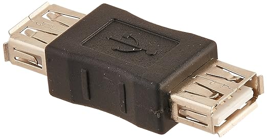

It appears to me more like a male USB plug, rather than a female receptacle. I expect you will need a female-female type A coupler, like this:

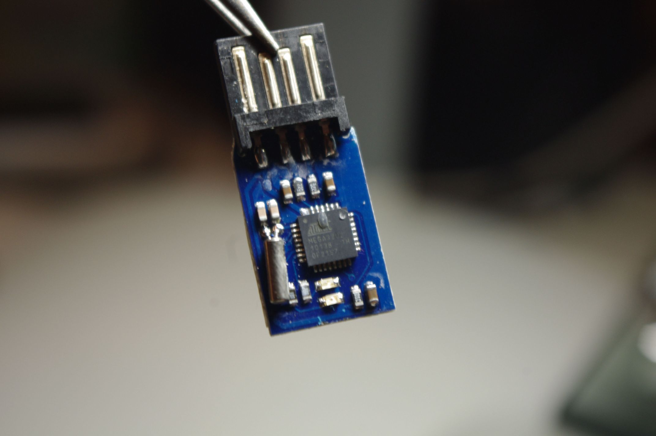

On the second image, there does appear to be 4 pins and not 3, so I am going with USB.

Definitely if is a USB I had tried all option < Male/ Female > & also slim USB , flip rotated J.
I has 4 pins, but due to the plastic mass no USB can be fitted.
I had look also to Ipod jack connectors and also they do not match this jack connector ar at least be similar.
So It looks like an USB but is not compatible with one.

The connectors are just blobs, but to me the USB cable should connector to the interface box with a proprietary cable.
The picture with the jack connector is after I had unmount the panel + plastic guide inside the central console <between front chairs>.
Plastic guide is mounded on the panel.
The jack connector in the attached images is clamped in the plastic guide.

Could it be some sort of Firewire port - there are 4 and 6 pins versions I think?
I thought the same thing, but looked at all of the various types of FW ports, and came up with nothing that resembled that picture. Then I thought maybe Thunderbolt, but Thunderbolt has angles on two corners ... Then I saw an eSata port that looked damn close to this but it turned out not to be it ... Whats throwing me off are the two arc shaped divits on the bottom of the molding, and the fact that it looks like whatever plugs into it, it will be some kind of PCB with 4 connectors on it and will look like its kind of floating in the middle of the rectangle that surrounds it (a rectangle that will have two arc shapes protruding from the connector.
This is obviously not a connector that has any kind of immediate nor common counterpart.
My guess is that it's some kind of proprietary connector for use only by automotive repair specialists or the dealer itself ... something custom made by the manufacturer to prevent user tampering.
What does it wire into?
I think what we're looking at is simply another unusual connector inside a car dash board that just HAPPENS to resemble USB, when in fact it isn't USB at all. Its probably some kind of connection to the head uints audio signal, or some kind of digital interface maybe for controls ... who knows ... here is a wiring harness for that car that looks like it has a plug very similar to this one.
I think the bottom line is, if you don't have a need for it, nor a matching connector for it ... then safely assume it is something that you can ignore and go on to taking care of other business.
