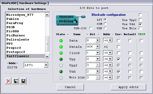

I like to use Tait Serial Programmer (Name in IC-prog) with Winpic800, because I need to program some PIC which is not support by IC-prog.
I have configure everything, and confirm the signal with voltmeter, but it does not work at all, however the programmer work well with IC-prog and Nigel's WinPicProg.
What's wrong? Is it timing problem? If yes, how to set in WinPic800?

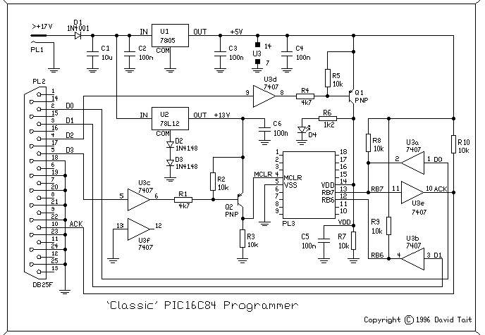

Problem solved
Problem solved, by the latest WinPic800 3.59 , have a option of changing delay clock under the *.hwp file.
DELAYCLOCK_LTP=15
DELAYCLOCK_LTP_NT=15

Hi dude i'm new to pic programmer and having some question regarding to the tait classic programmer you posted. In the picture you posted, there are two 7407 at the left hand side, the bottom one label with 13, and 12. what are these two number refer to? the 12 end should connect to where?? sorry i'm abit confused with those numbering. And is all those grounding to the same pin? can all ground point connect to the parallel port's ground(pin 18-25)?
The number refers to the pin number of 7407 IC. This IC is a 14-pin IC and inside it has 6 buffers, each taking up two pins as input and output pin respectively. 6x2 = 12 pins and the remaining two pins are positive 5V and 0V(Ground) connection pin.
So you really need a single 7407 IC to build the circuit. Just connect the pins with the correct pin numbers shown in the schematic.
The pin 12 is not connected to anywhere and left unconnected as the buffer is not used in the circuit, a spare one, so to speak.
Yes.

sorry i have 1 more question,from the pic what is the R4 value? how come it labeled with 4k7 ? is it 4.7k? and R6=1.2k?
and the 7805 and 7812 does it matter if i take 78LS05 and 78LS12?
yes, they are 4.7K and 1.2K.
This is a good way to describe the value of a resistor because if the value is printed as 4.7K, the fullstop(period) between 4 & 7 would easily disappeared after several photocopying of the schematic and one ends up with the value of 47K instead.
I have never heard or used 78LS05 and 78LS12. My advice is to use the 7805 and 78L12 for your circuit. Using the 78L05(TO-92) would result in it being hotter than the 7805 and they cost about just the same anyway.

If you can't get the 1A versions then the 78L05 and 78L12 will both work fine. They are rated at 100mA. If the circuit ever takes more than about 10mA then something is seriously wrong.
The supply current of 7407 alone is 29mA typical, 40mA max. This is in addition to the PIC current.
Still well within the capabilities of the 78L series.
