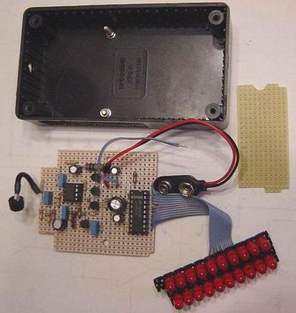

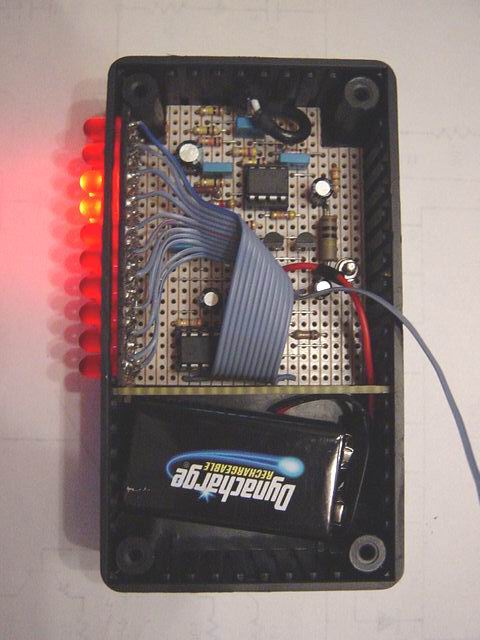

I designed and made a Sound Level Indicator project 6 or 7 years ago. It has an electret mic that picks up sounds. It has a few ICs and a few transistors. It has 20 LEDs and has a rechargeable battery so it can be portable but is usually powered from a wall-wart. It has a range of 50dB which is from a pin dropped on the floor of the next room to the stereo or TV (or my dogs barking) very loud.
Your problem is that you have an extremely simple circuit. It only has one input voltage that lights your LEDs. If the volume of the stereo is turned down then the LEDs will not light. My LEDs light with ANY sound.
