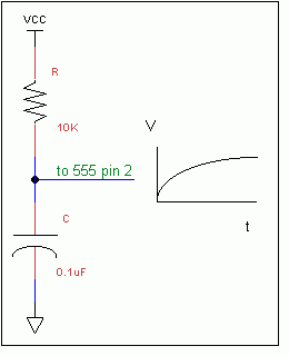

My question - How do I trigger the first 555? I would like it to "self-trigger" by powering up the whole circuit. I could just ground the trigger terminal, but that would cause indefinite triggering, and from what I read, the trigger time has to be less than the delay time.

power-up triggering 555
A simple RC connected to the 555's trigger input should work. The component values aren't critical, the values shown give a 1 mS time constant.

Thanks! Can you help me a little further? I need about 5 seconds for the first 555, so I guess I could increase R to 1meg and C to maybe 4.7uf. Then I'd like to tie the output to a second 555 to give me about a quarter second pulse which I need to connect to some kind of switch to give me a switched output. Can I tie pin 3 of the first to pin 2 of the second?

Yes, the ON time of a 555 monostable is about 1.1RC, so those values give you ~ 5 seconds. The pulse on the trigger input should go away before the 555 times out, so use a simple differentiator (cap & resistor) to connect the output from the first 555 to the trigger input of the second. You might want to look over the circuits at this site to get a few more suggestions & ideas on using the 555: **broken link removed**
