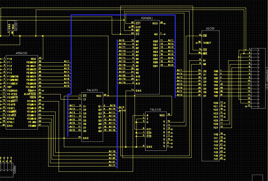

Hi all
sorry to disturb you guys again.
please solve my little query regarding 89C51 and 8255 interfacing.
below is the code which i am using with the ckt attached.
1. plz tell me whether i need external pull up for port 0 of the controller for interfacing with 8255 and i think i dont need it for RAM 6264 as i saw in a book Scott MacKenzie's.
2. Is there any fault in the circuit you see plzz do mention it.
3. I want to drive LCD and later want to attach a keypad too. plzz help if you have any other code or suggestions.
i have tried alot but no result used the same LCD with other circuits and is fine but no result in this one.
Used 8255 as memory mapped IO even tried in assembly but no outcome.
Thanx alot in any event.

I don't think people use such ancient parts these days?, as you're mentioning RAM presumably you're talking about a micro-processor based system, rather than a microcontroller?. The 8255 was never a very good PIO either, limited and difficult to use, the 6522 was a much more sensible device.
jawadlateef said:
atleast tell me do i need pull ups resisitor with RAM and 8255 on Port 0.
thanx
Looking thru your circuit I cannot see why you would require pullups to the 8255.
Long ago, I have used the 8255 many times in Z80 based units driving the Hitachi LCD controller, never had a problem with them.
Replaced them in new designs with the Z84C90.
As you have asked the question, I expect you are having a problem driving the display, ????
Perhaps you should tell us whats the problem.:)

i am the group member of Jawad Lateef, and he is actually asking will he be requiring any pull -ups resistors at the port 0 of AT89C51 and not asking for the pull -ups at 82C55, please correct, and tell us will we be requiring any pull- ups resistors at port 0 of 89C51.....
Thanx
with regards,
Muhammad Zubair Bhamani
Thanx
with regards,
The AT89C52 is a device I do not normally use, however I have read the datasheet and from the following extract I would conclude that PORT0 will not require pullups. IF it is configured as described in the extract, paragraph #2
IF you are designing a PCB layout, it would be an easy task to include the copper pads for a 9 pin SILR [+v and 8*10K].
This would give you the option for the pullups if the Vhi levels are lower than expected.
Hope this is helpful.
