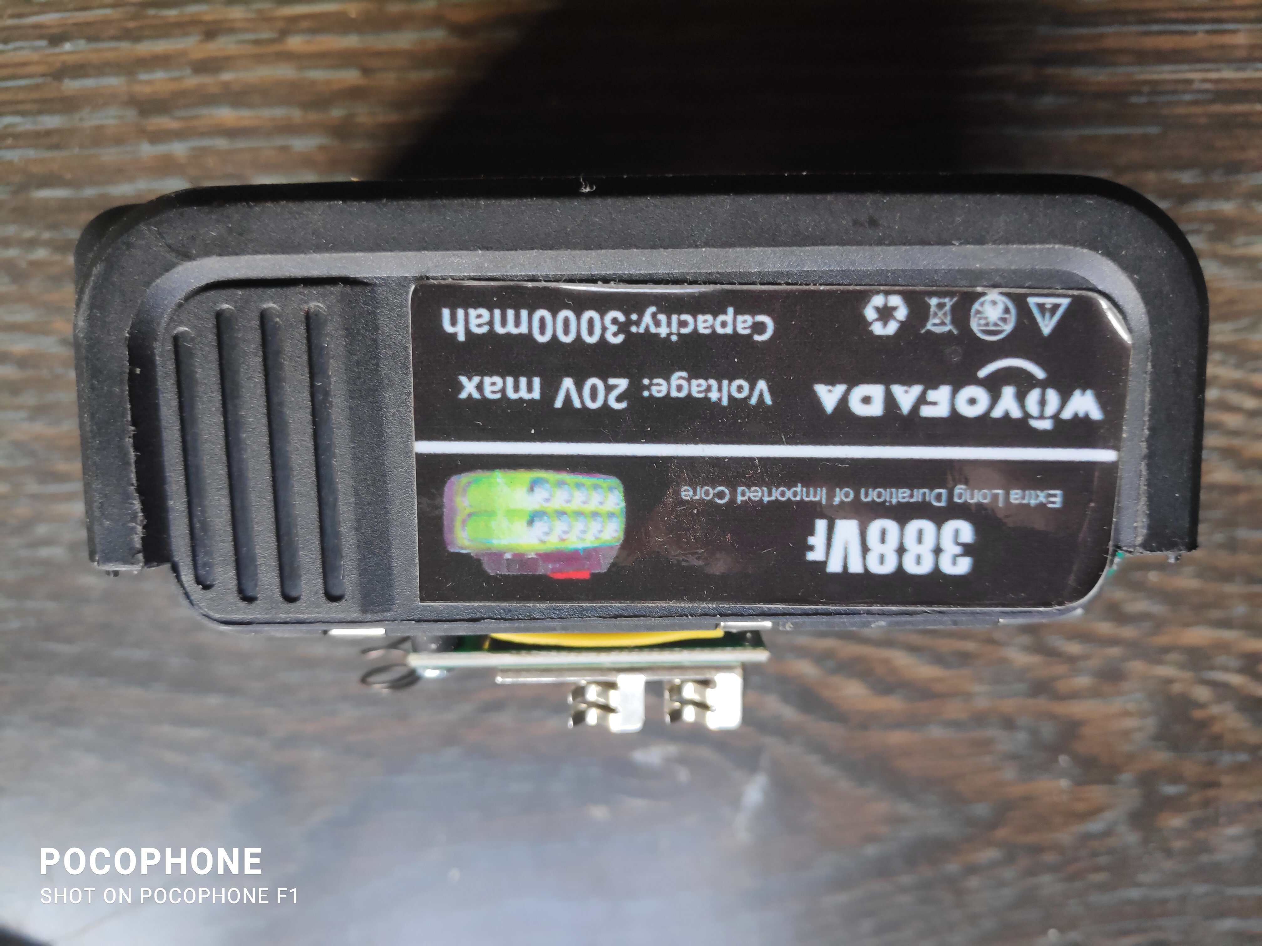

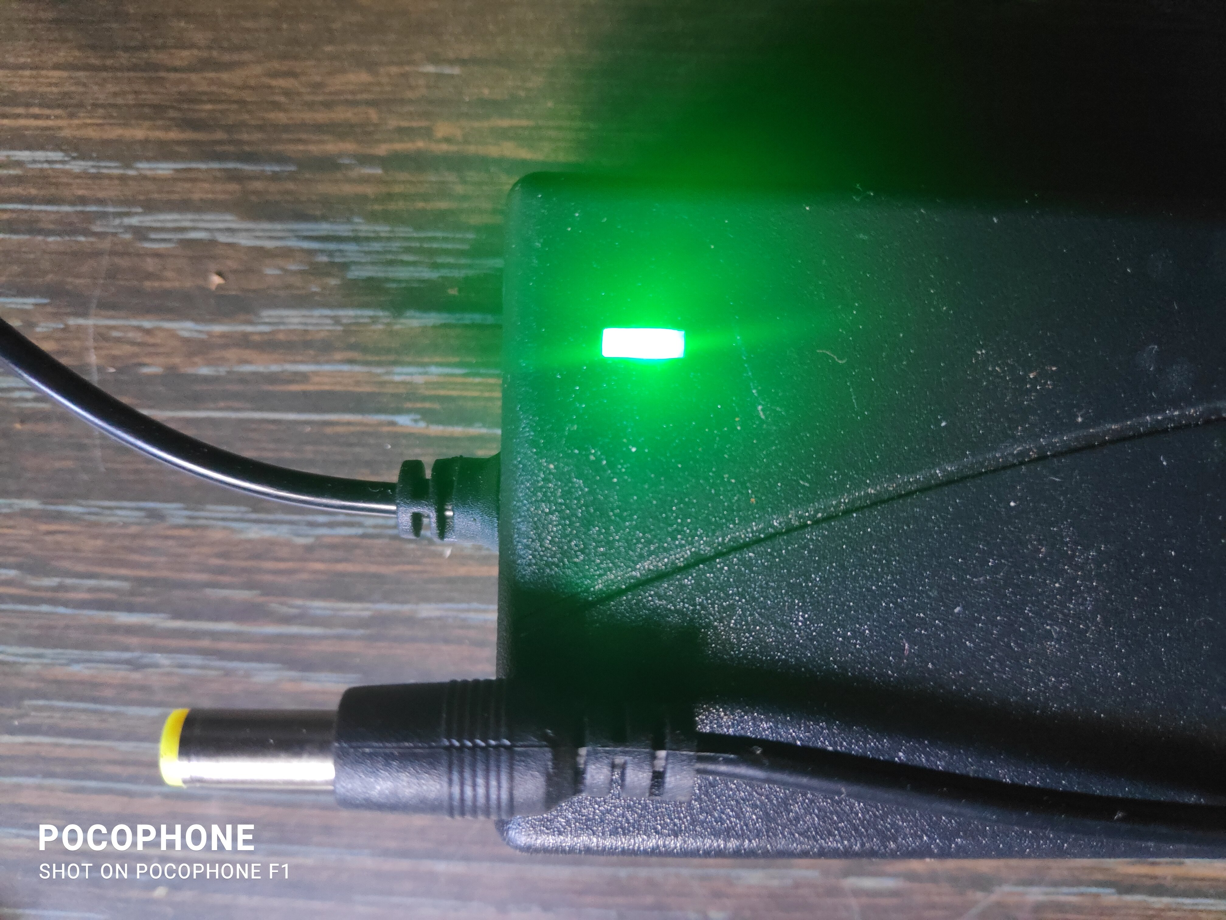

Hi, I would like to ask for your advice and opinion regarding a 18V Li Ion battery that I have. it was purchased from Aliexpress along with a clone of Makita impact drill. it came as a set of three - the drill, the battery and it's charger. I was only able to charge the battery twice and then it went dead. when I connect the charger's plug to the mains, it's led is immediate lights green (as can be seen in the attached pic), even without being connected to the battery's charging socket. as I know, it should be red until the battery is fully charged and then turn to green. could it be that the problem lies with the charger that doesn't provides current to charge the battery? I've measured the voltage on the socket - it's 21.58V and the voltage on the +B and -B battery terminals is 1.71V. on the battery's top there is a JY-MT-5S-V1.0 pc board, which I guess controls the charging. if my assumption is right, and the charger doesn't provide the current to charge, is it possible to connect an "external" power supply (with the correct values, of course), even if only to assure the assumption that the problem is with the charger, and see if it charges the battery? I'll appreciate any idea.
This is a big part of the story.
Is this the same impact drill as you had trouble with last summer? Or a different one?
The same one. I haven't used it since and I would like to know if there is a way to fix it or at least to find out which part of it is the faulty one.
Typically, the charger indication on simple chargers is based on current sensing; if the battery is not drawing current - so either no connection or fully charged - it may be green.
Red means charging current is being drawn.
The most likely problem is the battery is over-discharged.
If any cell is down to near 3V, the charge current should be limited to a few milliamps until all cells are within working voltage range - then normal charging can start.
Some simple charge controllers don't do the initial test charge current, so a low voltage cell just stops everything working.

Green constantly on with chargers such as that can often mean no current is being drawn by the battery - so either no battery in it. or a fully charged battery, when everything is working OK.
The problem you describe can happen if a battery is left flat too long; the cells discharge to the point a charger does not recognise it as a correct battery, so makes no attempt to charge it.
Some type of charger will apply a very low trickle charge; if the voltage comes back within limits, it will then start to charge normally.
Either, your charger does not attempt to recover the low battery, or it has discharged to the point where one or more cells fail - lithium cells develop internal leakage or shorts if discharged to too low a voltage.

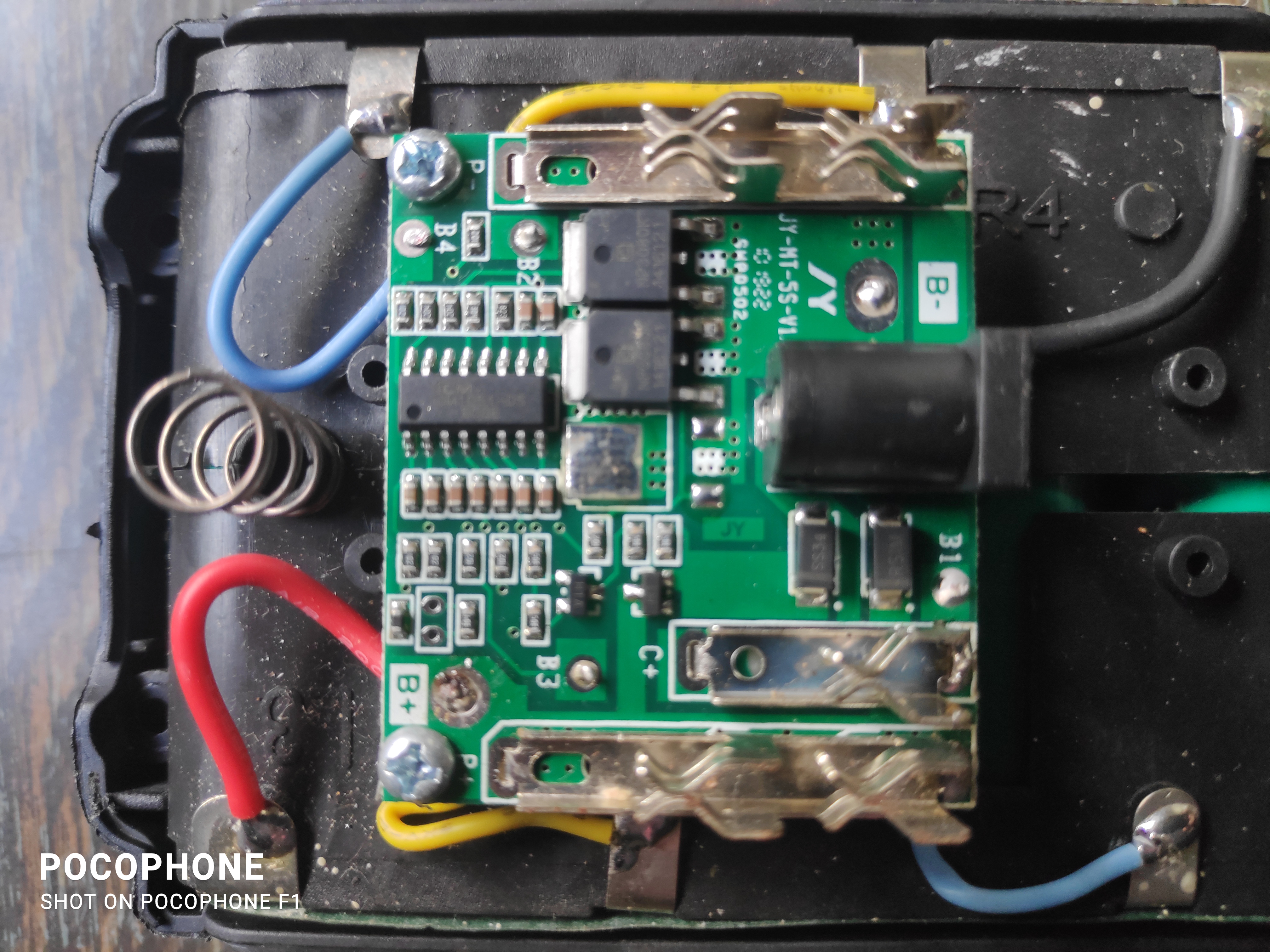

An 18V or 20V battery (same thing, different tool makers) uses five cells in series. The battery voltage should never get as low as 15V. If it's near or below that, that would explain the charger locking out. If it's at 12.5V or lower, some cells in the battery will almost certainly be wrecked.
Do you have a multimeter you can measure the battery voltage with?
As mentioned, the green light is just the charger "thinks" the battery is charged. (no current or volt above set value)
It is likely the BMS board (seen in bat2.jpg) is not allowing the battery to be charged.
The photo is not very clear so cant see for sure, it is fairly common the BMS board in cheap battery packs does not balance the cells or if it does the balance current is too low relative to the charge current so it will terminate charge when any 1 cell reaches Vmax. & some other cells are not near full.

21.58V would be the open circuit volt of the charger as the BMS is not allowing charge, no volt reading on the battery would be discharge is disabled as well due to some very low cells.

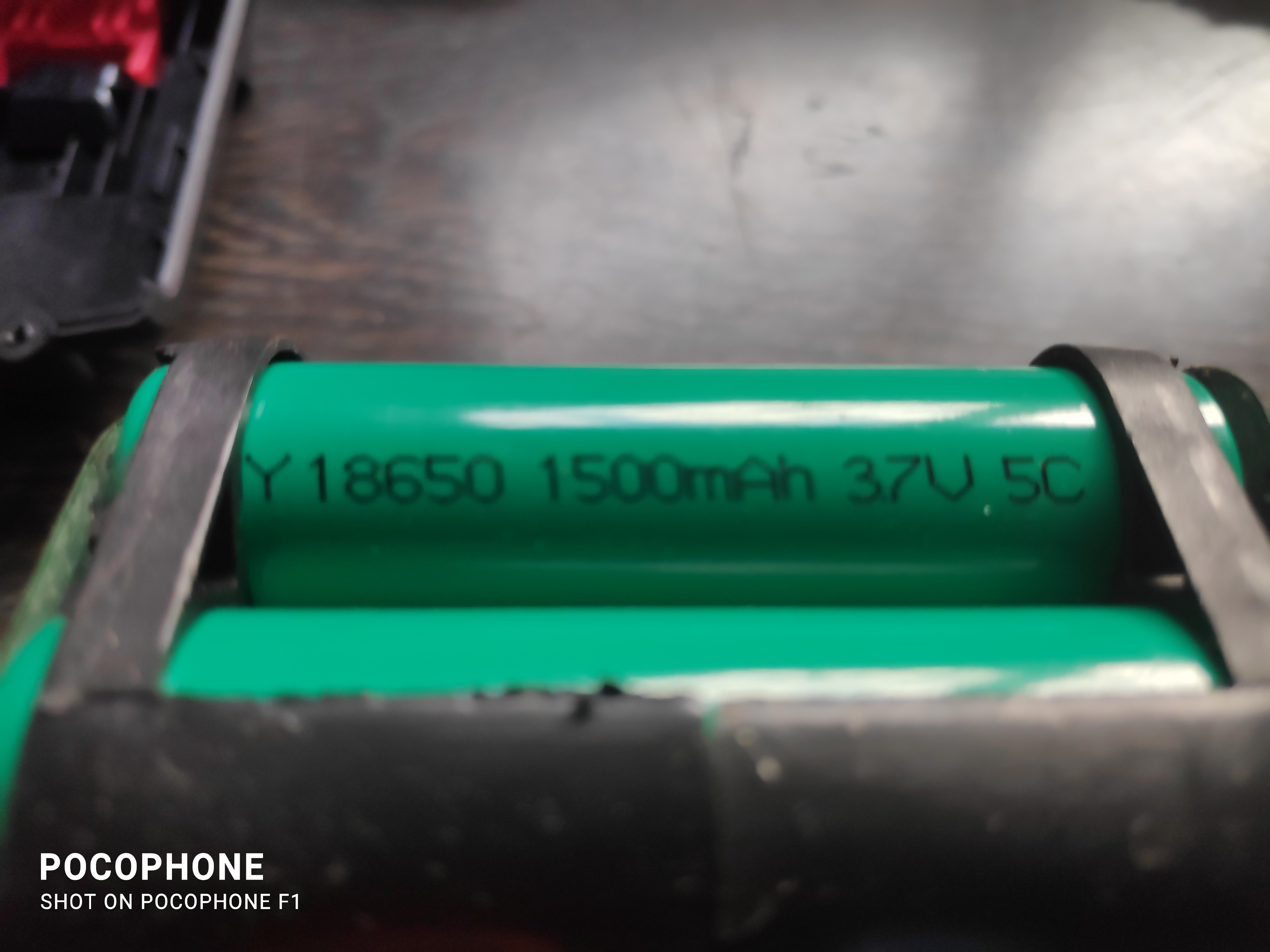

As others have said, the cells are so low that they are probably useless. Even the highest voltage ones are so low that there is a big risk of damage.
The "resistance" of the cells increasing when measured is probably the multimeter starting to charge them very slightly.
You could try charging each cell separately and very slowly to around 3.2 V, and seeing if you can then get the pack to charge.
Do that where nothing else is damaged if the pack catches fire. Also there could be a fault after a cell has been charged from nothing, so don't trust it not to go wrong until it's been working at least a month.
Thanx. does it makes a difference that the stack of the battery constructed so that every individual cell has another cell parallel connected to it? practically, when I'll charge one cell, it's actually two cells, it's done so to increase the A/h capacity of the drill battery.
