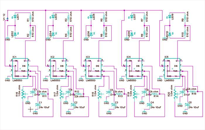

I am very new to this and wish to build a circuit that will flash 5 pairs of LEDs at variable rates. To do this I designed a circuit using 5 NE555 timers. To control the variable flash rate I want to use trim pots. I am having a hard time figuring out where to lay out the trim pot and what value to use. Can some one please help me? I have attached a screen cap of the schematic I designed in eagle.
I've had a couple of beers, so maybe I'm not seeing this right, but it looks to me as if the top row of Leds are the wrong way round. It looks like the lower row will light when the output is high, but if the top row is meant to light on output low, they are the wrong way round.
Back to my beer :D
Jim
Yes, all the LEDs are shown backwards.
Also, a resistor is missing at each 555 from pin 7 to the positive supply that would have a trimpot in series to adjust each frequency.
The 10uf capacitors must be connected to ground.
The circuit should have a supply bypass capacitor.
As noted above, there are several errors in your schematic. Here is an online calculator so you can choose your timing component values:
Thanks for the replies guys. As I said I am very new to this and designed the schematic in eagle after watching a few tutorials. I am basing my electronics knowledge off of 3 electronic classes I took back in high school. After 7 years the knowledge gained in those classes has faded somewhat. The season I had not completed the circuit is because I was waiting on figuring out what value trimpot to use.

Here is the revision. I think I got everything right this time. Thanks for being understanding with me and for all the help.
Your schematic is a negative. I fixed it. You saved it as a fuzzy JPG file type instead of as a very clear GIF or PNG file type so that is why it looks fuzzy.
LED 7 is not connected.
The pots are only 1m ohms which is only 0.001 ohms. Maybe they should be 1M which is one million ohms.
The datasheet for the LM555 shows two supply bypass capacitors. A 0.1uf ceramic disc and at least 1uF. Each 555 should have a 0.1uF ceramic disc and the entire circuit should have 100uF.

I have the background set to black in Eagle. I am a professional photographer and almost all of my photo editing work is done on a black background as it is much easier on the eyes. When I found out I could change the workspace in eagle to black I did. I just was to lazy to change it back to white before taking the screen cap. I saved it as a quality 90 jpg and on 4 of my computers it looks fine, but for every ones convenience I will save them as .gif from now on.
The pot's are 1M ohm. I just thought 1.0M was the correct way to write it.

Here is the latest revision. I replaced the individual LED's with small Mate-N-Lok connectors so I can move the LED's off the board and place them around inside the computer. I also added a 100uF Decoupling cap and a Mate-N-Lok 4pin HDD connector for ease of power hookup inside a computer case. **broken link removed**

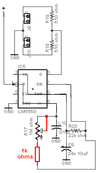

Your 1M pots do not have a variable resistance because their slider pin is not used. Connect the slider to one end. Each pot should have a resistor in series to prevent it from being adjusted to zero ohms.
You mean: connect the sweaper to one of the end leads of the pot or wire a resistor in series and connect the sweeper to one end of that resistor?
Do it like this for each 555 circuit:

I would like to thank everyone for all of the help notably Audioguru for all of his help.
Here is the final revision.
