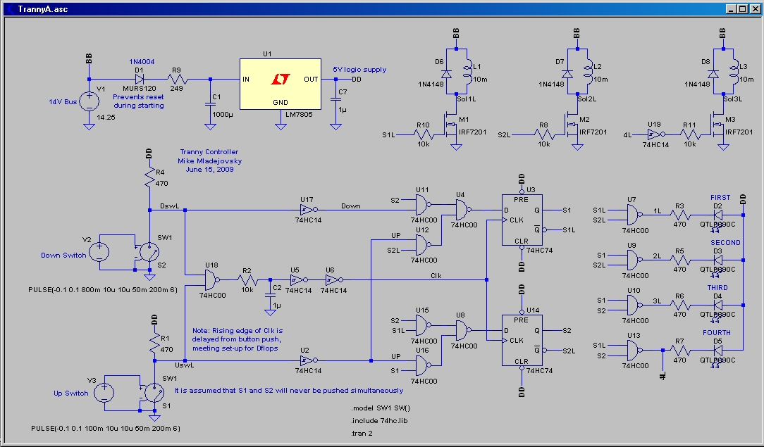

Thank you for all your help everyone! Here is the main details to my project. I am creating a push button shifter for my car. If the gear selector is placed in drive all four gears can be activated electronically threw there corresponding solenoids. 1st uses S1 and S2 2nd uses S2 3rd uses no solenoids and 4th uses S1 and S3. Also there is a corresponding LED on the gauge cluster that I will be using to indicate the gear I am in. That way if I use a 3 bit counter, the sequence would be 1234444 but 1234 would be ideal so I guess I should just use a 2 bit (I forgot about 0 being a output). If I can get help figuring out which IC will count like this I can use the outputs to drive a relay to drive the solenoids and indicator lights.

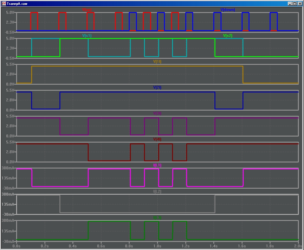

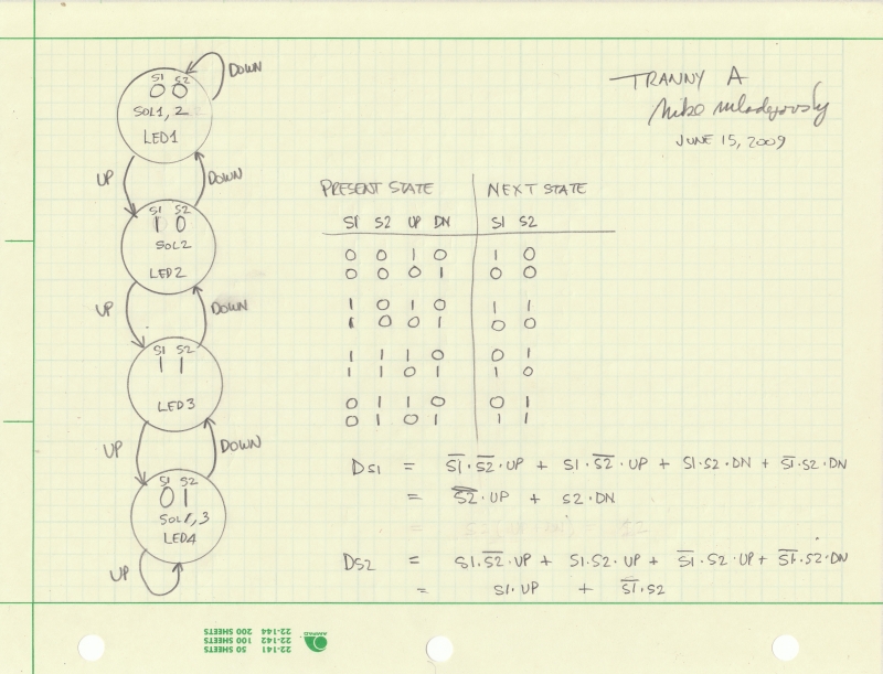

I redesigned it specifically for your case. There are two State Variables: S1 and S2, which count in a Gray Code. There are two inputs: UpSwitch and DownSwitch. There are 7 outputs: LED1,2,3 & 4, Sol1,2, & 3.
First look at the State Diagram. Note how I assigned the State Variables to the four states. Note that counting down from the First state stays in First. Note that counting up from Fourth state stays in Fourth. Note what outputs are asserted in each state.
The two terms DS1 and DS2 are the equations which implement the correct state transitions while shifting up and down. They become the D inputs to the two state Flip Flops, which I choose to use D flops for (rather than JK). I chose the order of the states specifically to make driving Sol1 and Sol2 easy. Sol3 is a special case.
The four LEDs are decoded off the states S1 and S2.
Note that V2 and V3 in the schematic are there for LTSpice simulation only; the switches are your physical switches. I would use a center-off, spring-return switch as the "gear-shift". Wire the common to Gnd, and the two sides to DswL and UswL, respectively.

I found the schematic for the gauge cluster that I am installing into my car. I am using the four triangles to indicate the gear I am in and the "driver controlled center diff module" is not there and that is where I need to hook this circuit into for the lights. If I take our R3 R5 R6 and R7 will the NAND gates be able to take the amperage or do i need to run four more IRF7201? If so how should I go about doing that?
Those are lamps, so you will have to buffer the Nand gate output, which can only sink 5mA or so. The Nand gate output is low when the lamp should be on. You could substitute four AND gates, which would give you a high to turn on the gate of a NFET. You dont need to duplicate the FET that drives S3.
Can I leave the four NAND gates and just sink it to four irf7201 that way I can leave 4L?
Not without adding an inverter between the nand gate and the gate of the FET. The nand gate produces a low at its output. The FET gate needs to be high to turn on the lamp.
I would buy one quad AND gate, add the four FETs, and use the FOURTH FET to sink both the S3 solenoid and the Fourth lamp by hooking them in parallel (top end of both connected to 14V)
