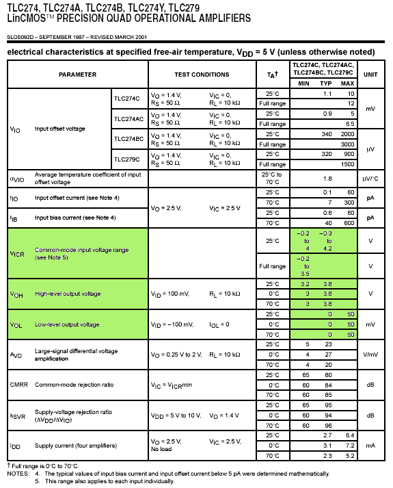

Thanks for all the suggestions Ron, I really appreciate them, I do have a quick question: Is there a table of common op-amps anywhere? I've been digging through data sheets, without much forknowledge of even the range of the values for the op-amp's I'm looking at, and it occurred to me that there is probably a better reference, is this true?
Also, how can I determine if something is "rail to rail I/O", for example, what in the following data sheet indicates whether this device has rail to rail I/O?

I don't know of a "common op amp" table. I generally use the mfr's search tools. The LT1499 you found looks like a good candidate. I guess cost would be the parameter that might cause you to do a thorough search.
Rail-to-rail capability is usually mentioned in the blurb at the top of the datasheet. The one below does not have rail-to-rail capability. Look at the highlighted specs. If the input is rail-to-rail, the common mode range will include the supply voltages. If the output is rail-to-rail, the output voltages will be within a few tens of millivolts of the supply voltages.
