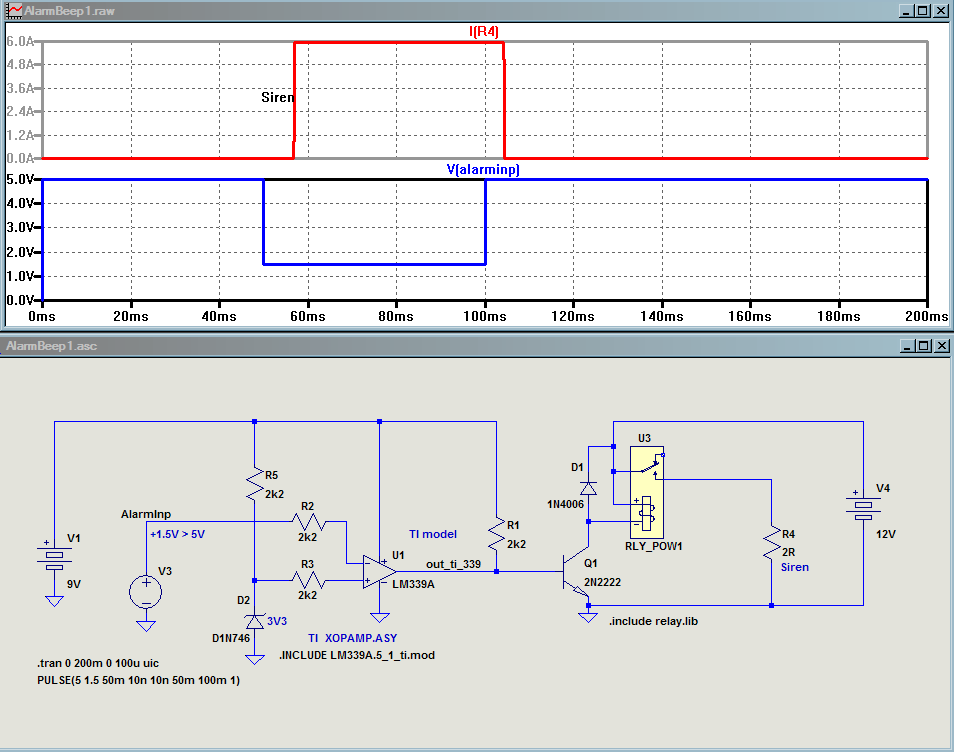

When using a LM339 as a comparator for the 1.5V and 5V signals you have to give the LM339 a reference voltage some where between the two limits.
Say about 3Vref, so when the output from the alarm is 1.5V the LM339 output is low and when the alarm output is 5V the LM339 output is high.
You will require a medium power transistor between the LM339 output and the relay coil. [transistor type like a 2N2222]
Do you follow OK.?
A circuit of this type would be ok for the project.

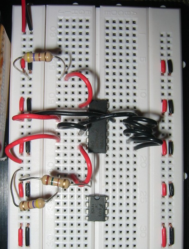

I have been focusing on just the comparator trying to get to that to work. My frustration has lead me to take a picture and hope you'll take a look at it. I've built a 25% voltage divider with some resistors (470ohm and 150ohm) I bought earlier and connected it to V+. 8V is coming out of my 9V battery, and is connected directly to V- and Vcc. Shouldn't I be getting 8V out of the output (since V+ < V-)? I'm getting 0V... swap V+ and V-, still 0V... Tomorrow I'll go to radio shack and pick up some larger resistors (maybe I'm giving it too many amps).
Per the diagram... I read before that the diode is to prevent the blowback from the coil when it disconnects. What is the 2N2222 transistor for?
At the risk of embarassing myself, maybe I'll upload the circuit I had drawn out before :)

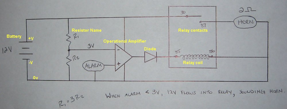

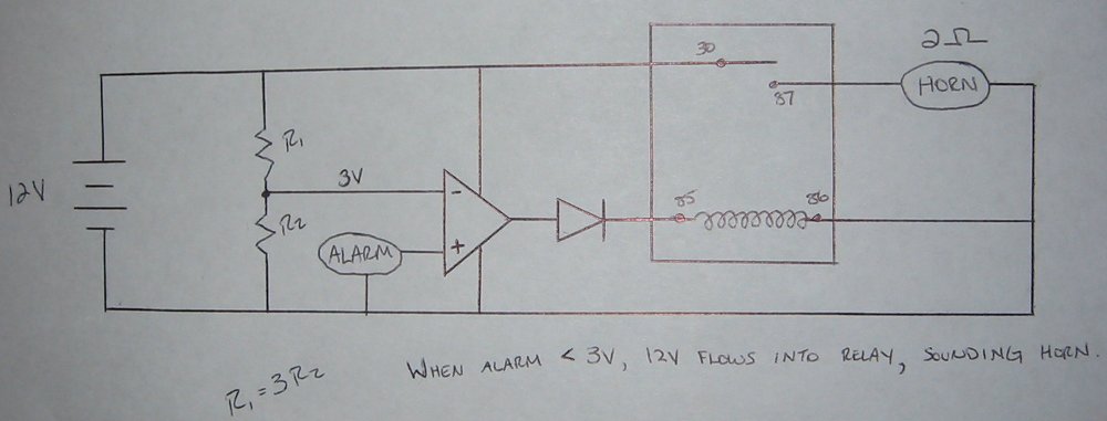

I beautified my circuit so it is fit to read... whether or not it actually makes sense is another matter. If it would not work, I would be grateful to learn why.

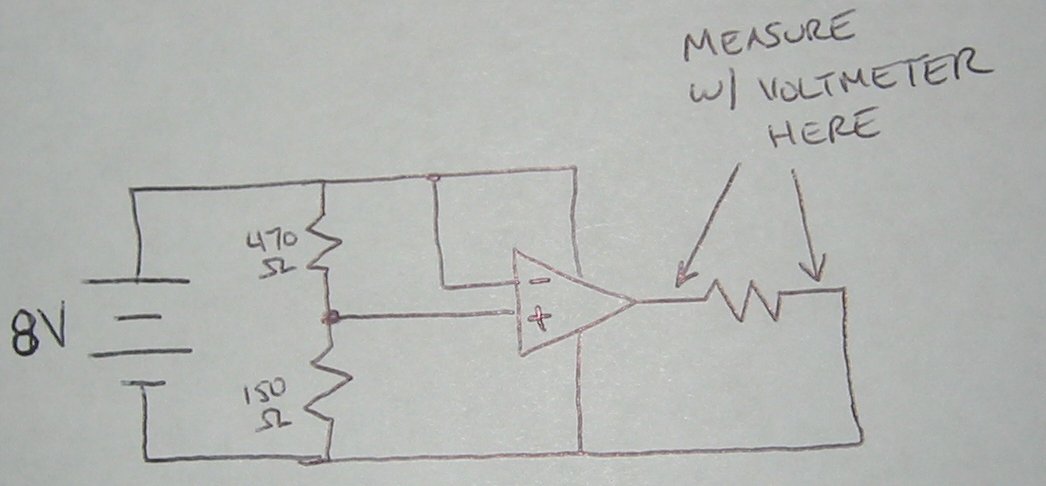

The complete circuit I just posted was not meant to be what I showed in the breadboard... I just happened to post it a minute afterwards... Sorry about that. I'll show what I was trying to do on my breadboard in a couple minutes.
Here is the small circuit that I tried implementing on my breadboard. When I measured voltages, I always read 0V.
You will always read 0V.!
The LM339 is an open collector output, add a 2K2 from the output pin to +Vsupply.

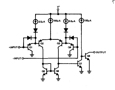

Look at this image of the LM339 cct.
Just a few moments ago I got the horn sounding off of the alarm clock. Thank you very much! I am still confused a bit about what an "open collector" is exactly and how it works (even after going to wikipedia)... I'm seeing that this output pin acts almost as if it's a ground when it is "on" and it acts as an open circuit when it is off... is that a good way to think of it?
Thats a fair way to think of an o/c output.
Its basically a switch,
when the switch is ON [transistor conducting] the external load resistor is connected to 0V, current flows from the power supply thru the external load resistor.
When its OFF [transistor not conducting] the external load is disconnected from 0V , so no current flows in the external load resistor.

Which post number are you referring too for the circuit.???
Post #7 seemed to be the one I understood clearest yet i am still a bit hazy with the details
Added some comments on that circuit.
In the circuit shown the diode is in series with the relay coil. That won't work. The diode, for spike suppression, should be in parallel with the relay coil with its cathode connected to the positive supply. Also, a transistor buffer stage (the 2N2222) should be between the comparator output and the relay coil.
The OPA going high drives the coil via the diode, the low side of the coil is connected to 0V, so it will work if the OPA is able supply the required V and I,,, a diode across the coil is also required.
Agreed. But if the diode as shown isn't for spike suppression what is it for? It seems redundant.
Further, the comparator shown in the sketch is wired with the wrong polarity; its output goes high when the alarm input goes above 3V.
