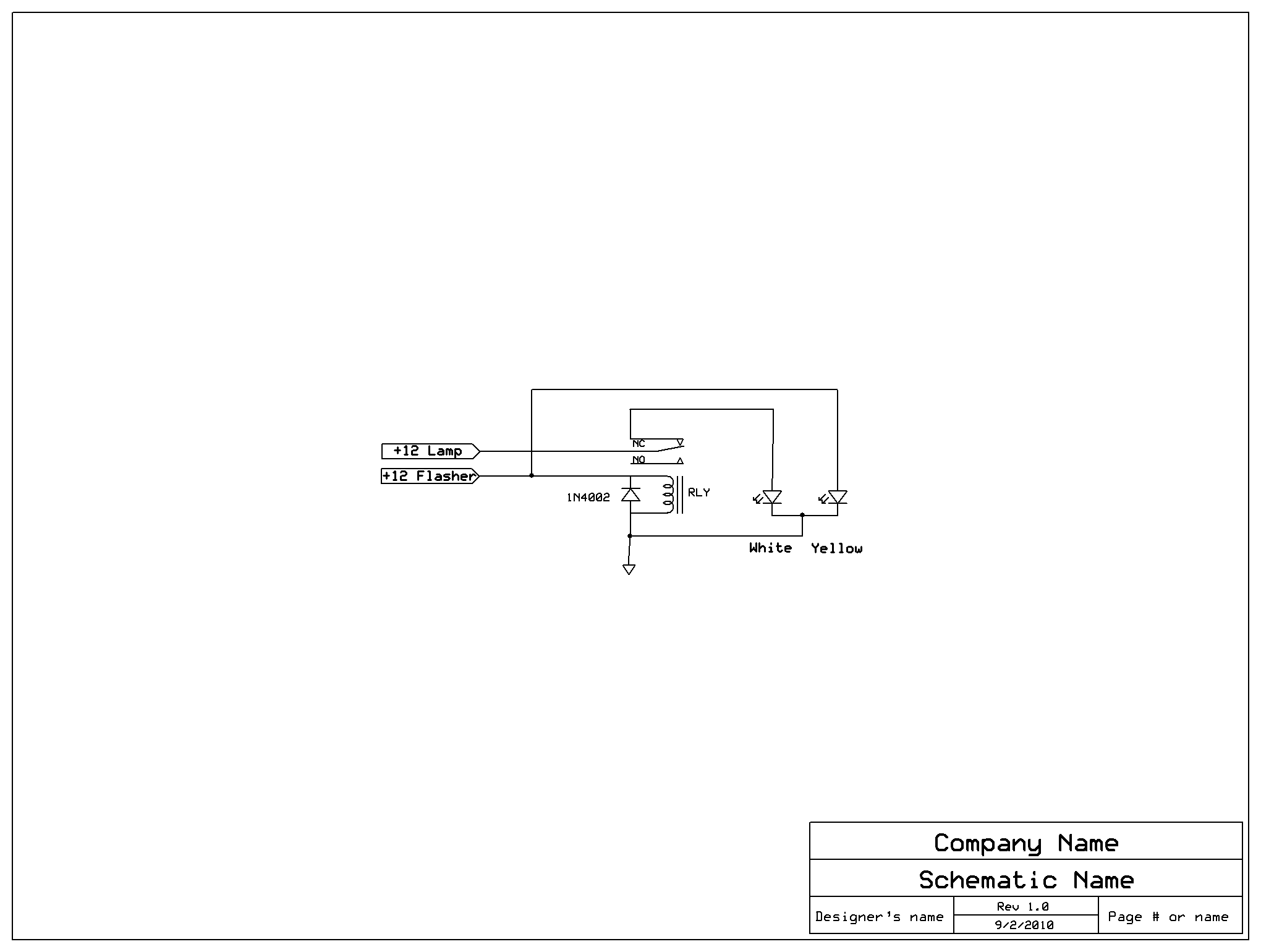

Bought a couple of change over relays today so I can utilize the normally closed function. Here is the result (using my bench top power supply for now)
I'm going to post a quick schematic to show how I've hooked it up, so people can check to make sure there won't be any feedback issues or anything..

you can use a 4011 NAND gate IC and a transistor too for the purpose. power to orange is inverted to enable the drive transistor of white ones.
