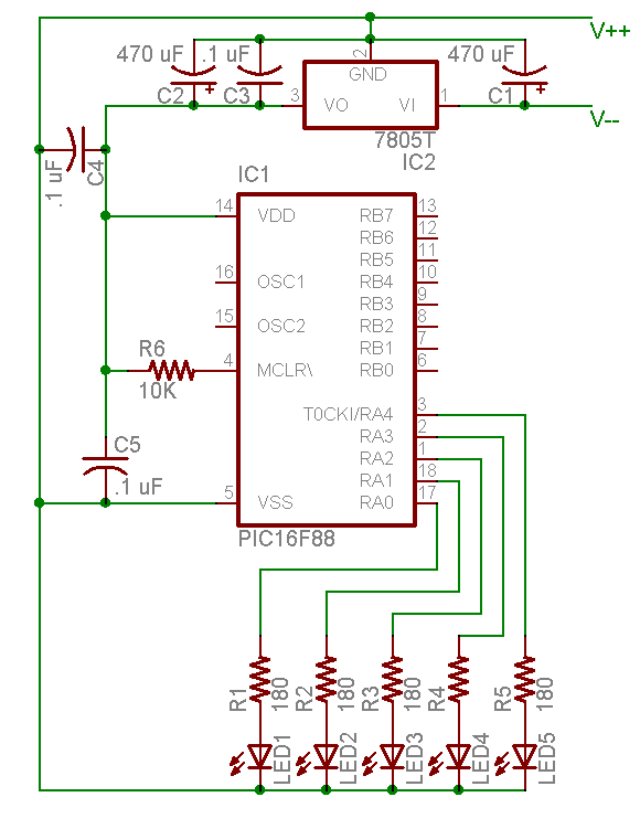

I have an electronic circuit, currently breadboarded that I am working on. Here is the schematic: **broken link removed**
The microcontroller should light LEDs in alteration, first one set, than another. However, all it does is turn on the first set of LEDs, unless I touch one of the wires on the breadboard. Then it starts acting as normal, until I let go, at which point it goes back to the first set of LEDs. It does not behave this way when I touch it with a pencil or another wire however.
What can I do to fix this?

hi logan,
Its most likely an 'open', floating pin on the PIC. Its picking up hand capacitance or hand contact.
Check the datasheet and look for unconnected pins, which must not be left 'floating'.
Is this clear, if not just ask.
EDIT: is the drawing of complete circuit or are there 'bits' missing?

I think the problems may be due the plastic breadboard. I have built circuits on these and noticed similar strange effects. Seems that the larger the board, the more troubles one can have. What seems to help is having an electrolytic cap where the power supply enters the board.
The strange thing is that it happens no matter what wire I touch. I already have caps at the power supply.
What is shown in the schematic is everything that I have connected.
It does the same thing even on a smaller breadboard.
I have not setup the unused pins as inputs or outputs, just ignored them. Should I TRIS them as inputs and ground them?

If you have programmed the PIC yourself, have you correctly configured the CONFIG bits ?.
I would try setting PORTB to all outputs, just to avoid any open inputs.
Can you post your coding along with the Config header.?

C1 is doing nothing, you can remove this, or move it to the input side of your regulator. What I don't see is small bypass caps - 0.1 uF both near the pic Vdd and Vss connections, and between the regulator and C2. This could be the reason...
I would also take Eric's suggestion about setting your portB to outputs.
What do you mean by two small bypass caps? Where between the regulator and C2?
small ceramic capacitors, for example mono 104s
From Vo to ground, but before C2.

Okay, I have modified the schematic and circuit to that that is attached. However, it still does not function as it should, and I am having the same problem that I had before.
Here is my code (I will try setting PORTB outputs soon). Sorry for the sloppiness, but this is just test code to make sure that the circuit is functioning correctly.
