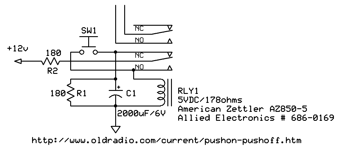

I am upgrading dashboard/switches in my car to a newer version, but I have come across a problem with the hazard switch.
Basically, the original switch from my car was latching, so when it was pressed, it would make a circuit and provide a continuous ground feed to the necessary input on the car's electronics module, and the hazard lights would flash. When the switch was released it simply broke the circuit again.
Now, on the facelifted car dashboard, the new hazard switch is non-latching, when it is pressed it provides a momentary ground pulse to the electronics module and turns the hazards on. When it is pressed again it provides the same pulse to turn the function off on the electronics module.
So..... I need to make my new non latching switch to provide a permanent earth to the electronics module on it's first press, and to remove the earth when pressed again! If anyone can offer any guidance as to a circuit I could use to produce this effect then I would be most appreciative!
