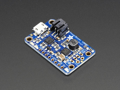

You'd be better off operating it with one battery so you don't have to worry about balancing the two lithium cells. Adafruit.com makes a small circuitboard that can charge a lithium battery safely and then boost the lithium battery voltage to operate USB (5v) devices. Super simple if you can regulate the voltage from your solar charger to 5v (input voltage for the LiPo charging circuit.

yes, the Adafruit device is intended as an uninterruptible power supply so it can be changed and power an external device at the same time. See last part of below description of the adafruit part. Also, for projects needing less than 1 amp, there is a 500mA version for $5 as well.
Since the built-in battery charger has load-sharing, it will automatically switch over to the USB power when available, instead of continuously charging/draining the battery. This is more efficient, and lets you charge-and-boost at the same time without any interruption on the output so its fine for use as a "UPS" (un-interruptable power supply). Please note that this board is designed to be used only with a LiPoly attached, it won't work without a battery.
