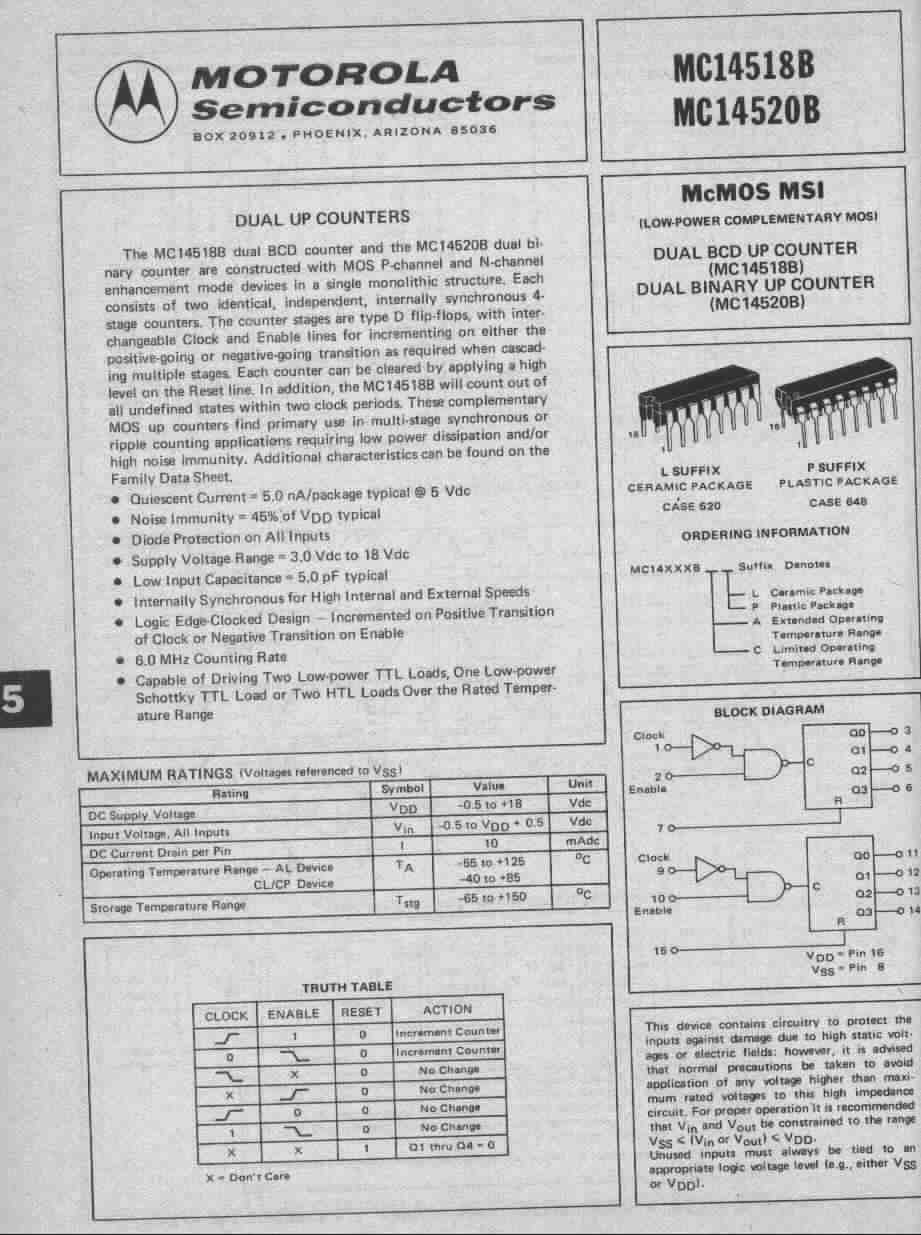

Can someone explain to me how to use a schmitt trigger to debounce a circuit. Also does anyone know the pin outs to the 4518B as i am making a decade counter using a seven segment display.
I would not use a schmitt trigger for debounce, an R-C filter is easier. the pinout is below.
Russ, an RC filter is generally followed by a Schmitt trigger to give a fast risetime, as you undoubtedly know. What configuration do you have in mind?
