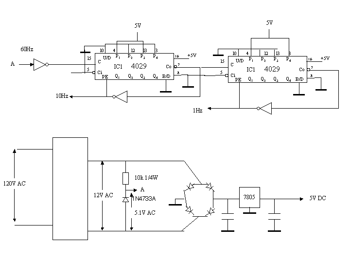

I have a 6 and 10 counter to be the frequency dividers. I'm having trouble getting the 60Hz to begin with. I have the resistor and the zener tied across the 12Vac transformer, but I'm not coming up with 5.1V, it is more like 8.

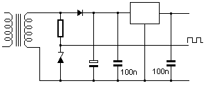

Please post Your sematic. I think the problem: need independent winding for clock signal source, or use one-way rectifier.

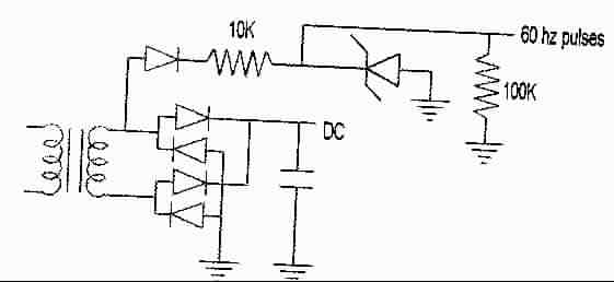

Sebi, that is almost exactly my schematic. I have a full bridge rectifier though.
I may just use a 555 to get a 10Hz clock and then use the counter to step it down to 1Hz (as I need both for my circuit).
I keep hearing people talk about using a watch, but I wouldn't even know where to look.
The rectifier is not drawn right, but it is installed correctly.

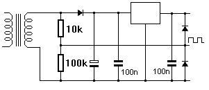

For proper potential of 60Hz, need common GND with DC section. Forget the bridge, use one diode and connect 100k resistor paralel with zener.
Another possible solution:
Alex,
You will also need a Schmitt Trigger to reduce the rise and fall times of the signal before you apply it to the Modulo 60 counter. Some counters are fussy about the rise and fall times.
Len
ljcox said:
Alex,
Len
I was going to run it through an invertor. I have an extra schmitt trigger Nand gate on my board right now, I guess that I could use that instead.
[/quote]
I was going to run it through an invertor. I have an extra schmitt trigger Nand gate on my board right now, I guess that I could use that instead.[/quote]
I doubt whether an inverter would make the rise and fall times short enough.
You could use the Hex Schmitt Trigger inverter, 74C14 or 40106, etc. Note that these can be used as normal inverters when the Schmitt action is not necessary.
Len
It worked like a charm, I just have to change the input to the divide by 6 to 6 and then it worked great.
