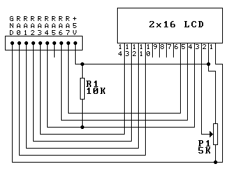

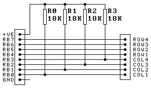

The hardware is wired the same as Nigels with the exception of an LED
and resistor going from rb3 to ground and nothing else on rb3. And a 3x4 keypad of course.

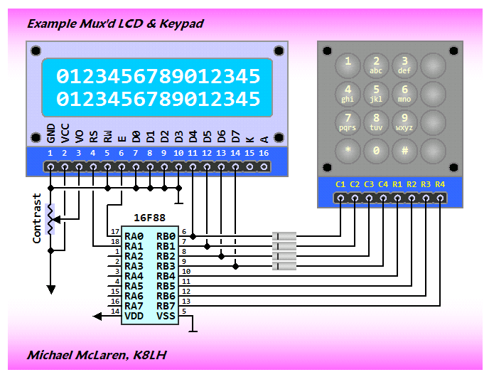

You can re-task the LCD D4..D7 lines to drive the keypad columns (or rows) to free up 4 pins...
Hi Mike, can you show me an example of this? I think I understand the software side, but I'm unsure how you would isolate the hardware. Thanks for your input.
Here's one of a hundred ways you might do it. Basically the LCD ignores data placed on the D4 through D7 lines and the RS line until you strobe the E line so you can borrow those lines to drive the columns or rows on your keypad in between writing to the LCD. The diodes prevent shorting out a high output to a low output if multiple keys in the same column are pressed at the same time. The diodes in this example are set up for sensing active low key presses using the internal PORTB pull-ups and requires setting only one of the column lines low at one time when scanning the keypad. If you look you should find plenty of examples like this on the 'net.
Happy Holidays, Mike
