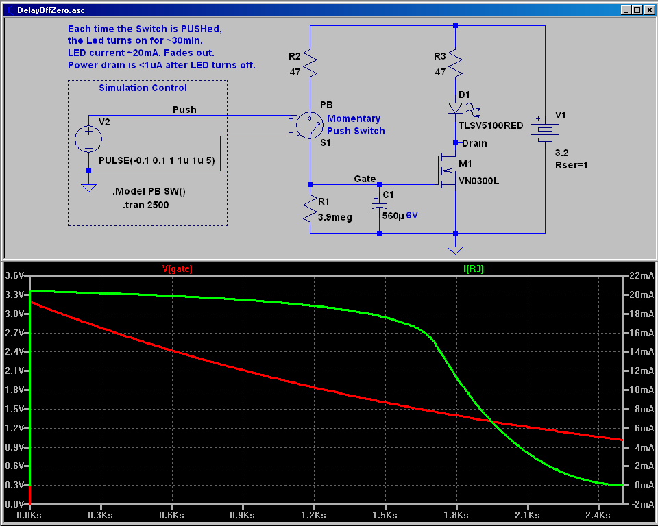

The base current of an NPN will discharge the capacitor much too fast. If the circuit could operate on a voltage higher than 3V, then the capacitor could be used to turn on the gate of an NFET, where the discharge time-constant is set with a 1meg or 10meg resistor.

Here is a fairly simple circuit. The NFet is sourced from Mouser. The switch can be a normally-open push button, tilt switch, or whatever.

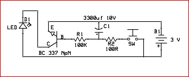

Ok there is more efficent ways of doing this, but a quick test on the bench with a few parts lying around gave 10+ minutes of good brightness of a white ultra bright led then leading to a steady fading of the led.
The switch can be replaced with a mercury tilt switch.
I didnt have a Fet handy so just used a transistor.
The capacitor can be doubled up to extend the time.
A 10 volt cap is not over large and would fit the size area ok.
Im sure someone will come up with a better solution but it dont get much simpler than this.
The transistor is upside down. Putting in a second NPN connected as a Darlington with the one already there would make for longer delays with any given capacitor.

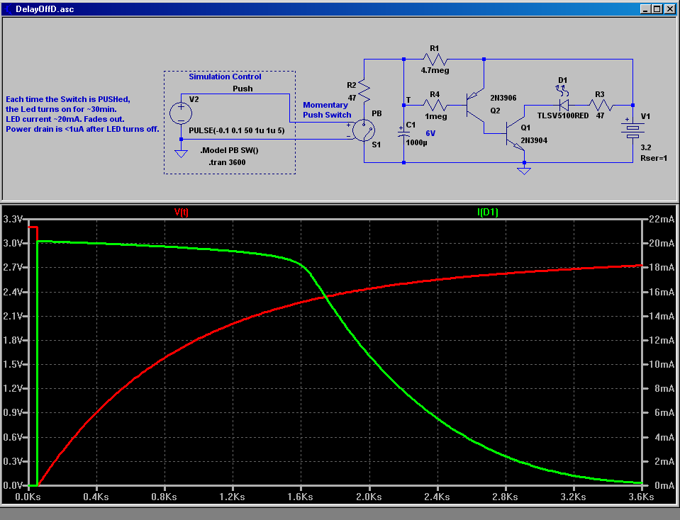

Here is yet another version. It uses more readily available PNP and NPN Darlington-connected transistors.

The lead with the arrow is Emitter; the lead at right angles to the bar is Base; the unadorned lead is the Collector.
A fresh Alkaline AA or AAA is 1.6V
The length of the timing period is proportional to the capacitor. If you want more time; get a bigger capacitor, or hook two in parallel, observing polarity. YOu should be able to buy 470uF, 1000uF, 1500uF or 2200uF.
I corrected the transistor that was backwards in my earlier schematic (whoops) and added a resistor between the switch and cap as with a small switch the inrush current to large caps would be huge and burn the switch contacts, also added EBC labels to the transistor.
Yes i agree a second transistor would extend the period but did not add it to the schematic as that has been covered by others. (i actually expected bad press from such a simple crappy circuit)
