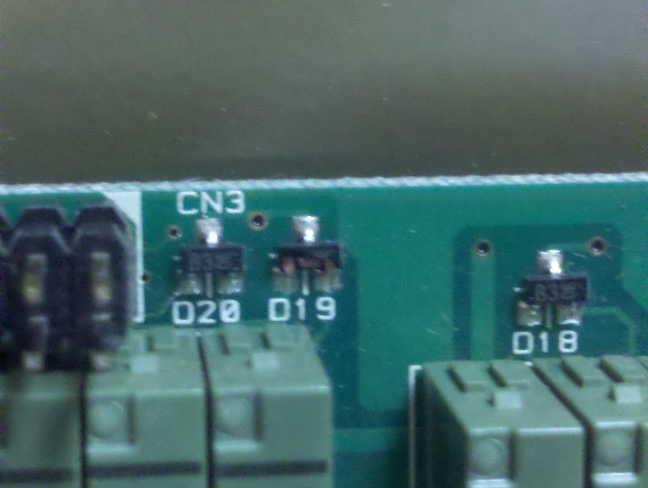

I really need help identifying these components so hopefully I can repair this device.
First I will tell you the parts in question are on a board that is part of an output board on a PLC unit.

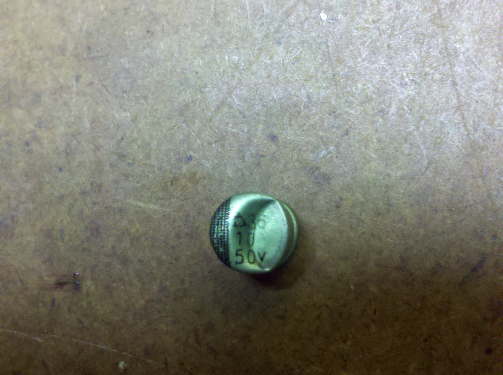

I believe the small green one is a capacitor, although I don't know the values.

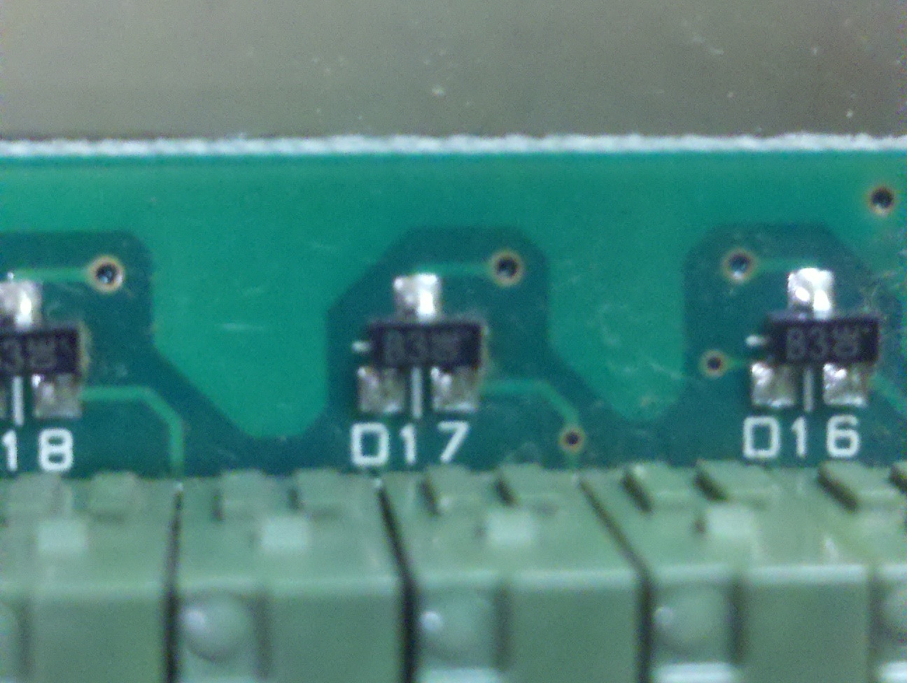

The one I really have a problem with is the small black ones.
I believe they are zener diodes but have no idea if I'm correct or what to replace them with?
If I remember right I connected AC where DC should have been or something like that and pop!
Here are pictures taken with my phone. I can get clearer pictures on anything you need if necessary with a much better camera.
Thanks in advance!

The cap looks like a 10 uF electrolytic.
The 3 pin devices appear to be diodes, given their D numbers.
I expect there are 2 diodes in each package with either a common anode or common cathode.
Have you used a DMM set to the diode setting to measure them?
Do a search for the number printed on them in the SMD area of a supplier's web site.

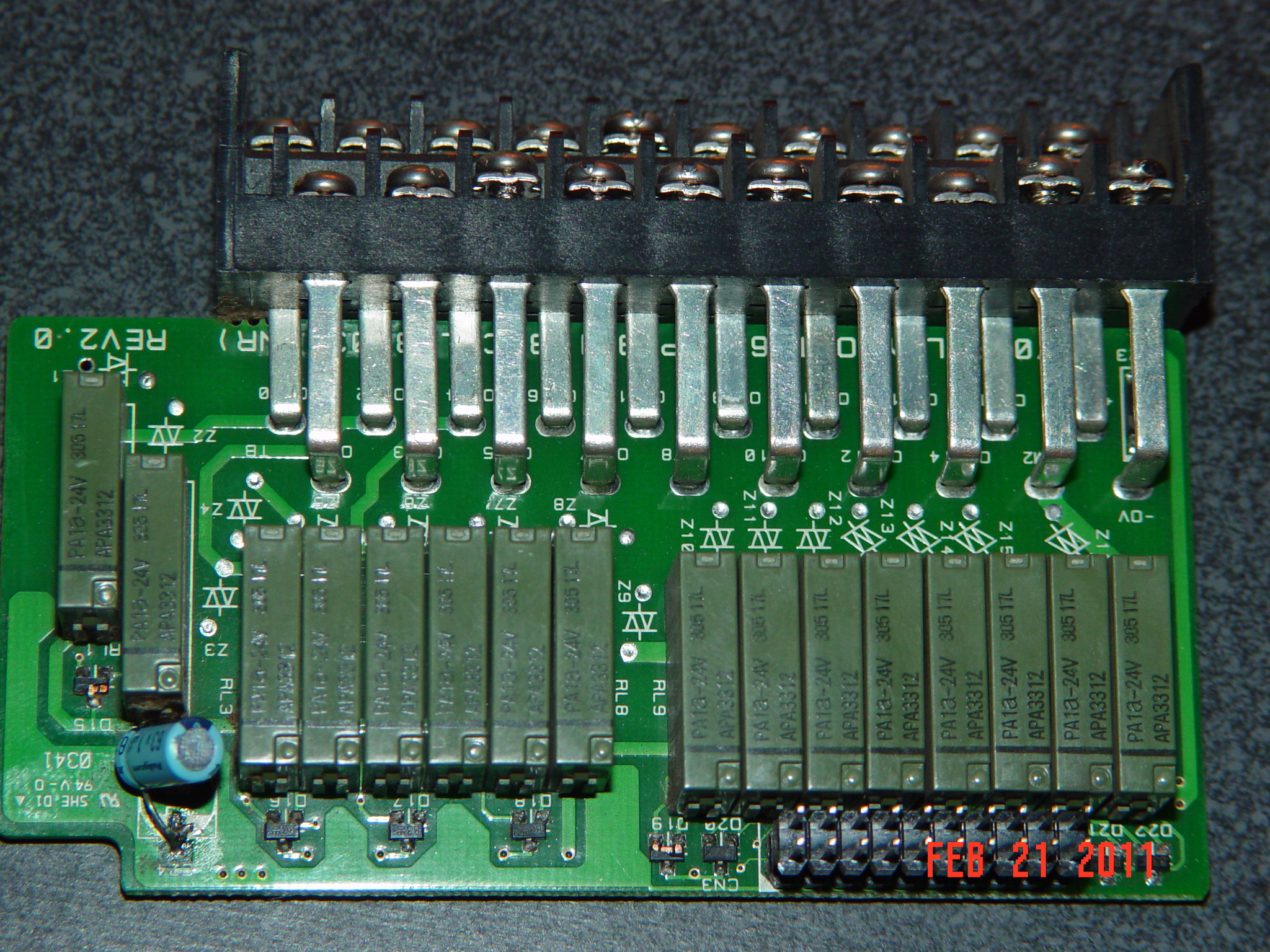

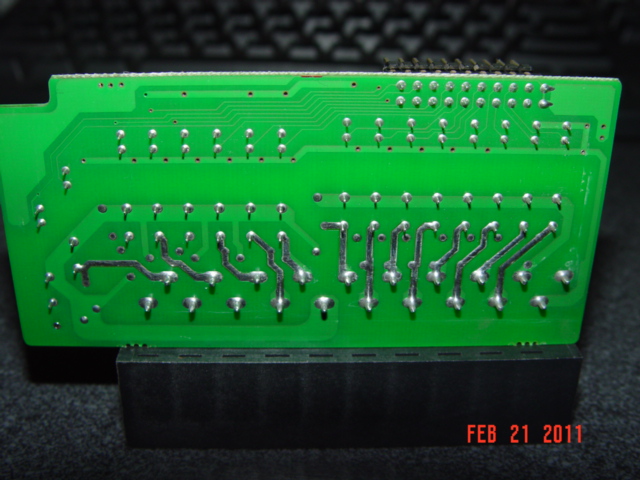

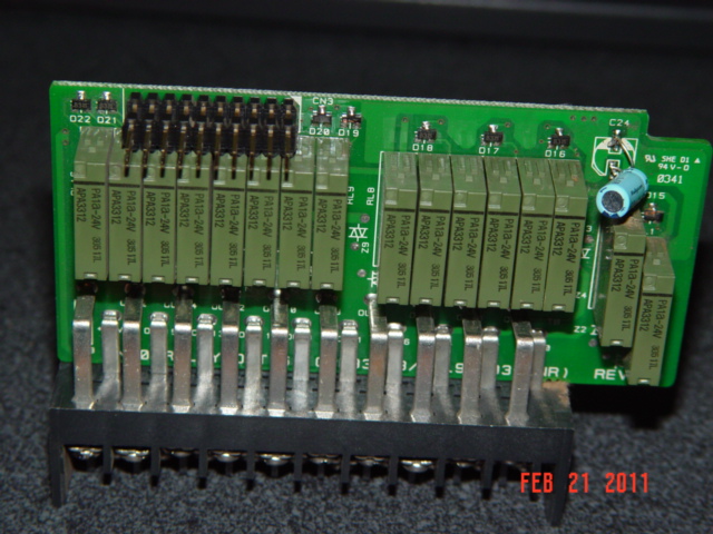

Here are a few more pictures of what I'm working with here in case anyone has any more suggestions.
I am going to start testing things today and will post results in a few hours.

Ok, I tested the good board and believe I found that the diodes are common anode.
When I connect red test lead to double side of diode and black lead to opposite side I get a reading of 800. When switched around get a reading of open.
Testing diodes on damaged board results in:
By the way D23 is where the 24V is to be connected and 120V was instead...
