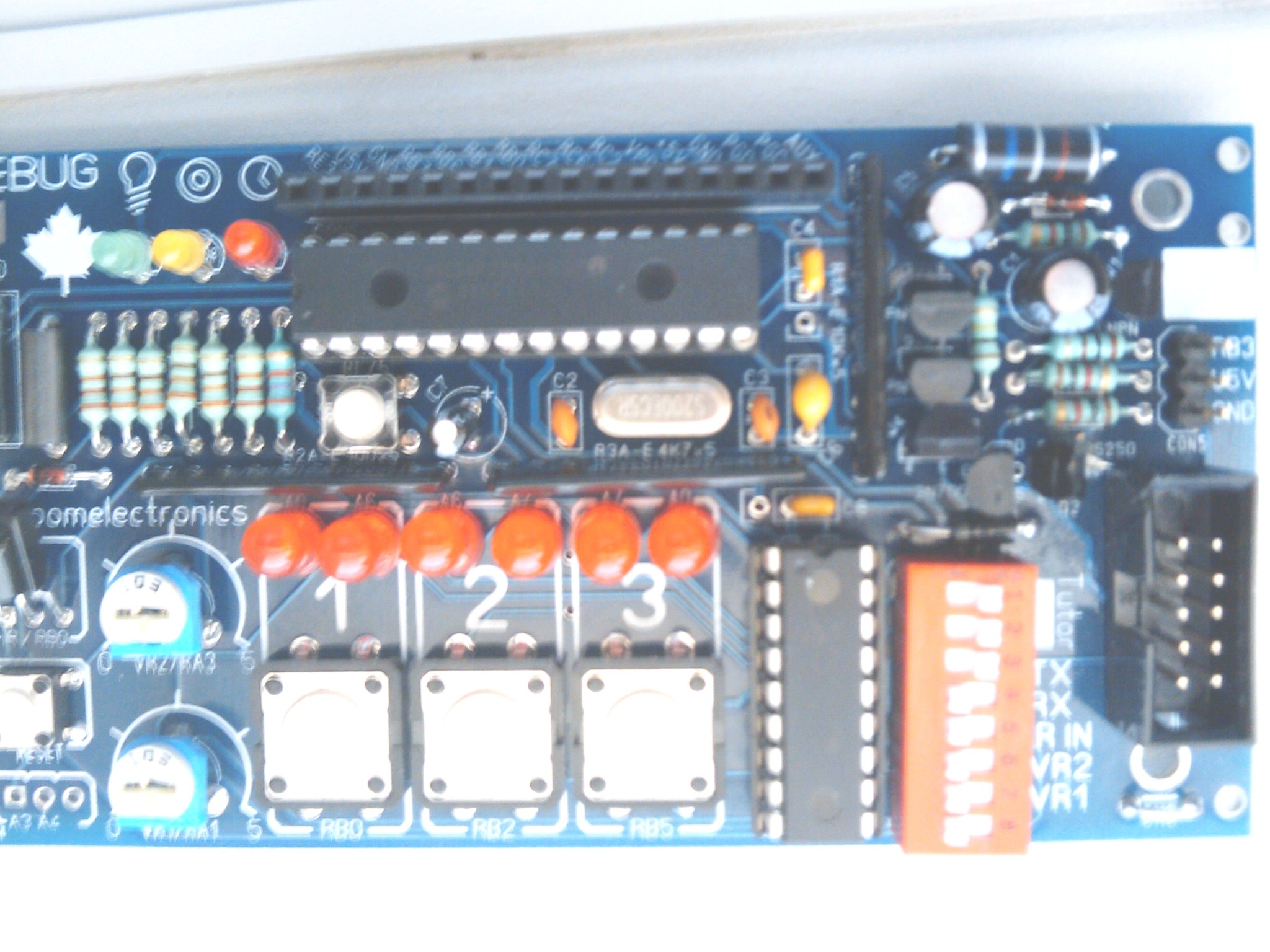

I received the kit yesterday and assembled it lastnight. I am trying to flash the led's with this:

It seems like it programmed ok. No error messaged but only the green and yellow led light up. The 3rd big red led just barely makes a visible flicker.
I am not sure if something wrong with junebug or if I programmed it wrong with mplab.
I hit file and new and then copied above code and then clicked program to taget device. The small red led lights up for a second and then its over so I guess that part worked.
Please help. I have a volt meter which I know how to use and a oscilloscope phillips pm3365A which I dont know how to use yet but I have it set up.
The red LED (Busy) should only flicker while the programmer is in use.
There is a run release button in MPLAB or turn DIP-1 off (this will disconnect VPP/MCLR from the programmer)
The small red led only light up during programming. Its one of the 6 red led's that barely flicker. The other 5 do nothing.

ok, In mplab I reinstalled the above code and clicked release from reset.
Now The green led is on.
and 1 of the 6 red led's is lit steady. No blinking though.
The tutor is not programed . What your saying is you have holding it in your hand dip switch on the right led four to the left is barely flickering that' s what mine dose till I program it. If the led 4 is not fickering it's set to hold in reset. One more thing make sure you have Q4 installed right.

its not hold in reset anymore because I Clicked release from reset but the Red led 4th from right is lit up at about half brightness. I believe q4 is installed correctly.

ok used pickit2 and now all leds are flashing from left to right. The green and yellow are still it. Is this correct?
3vo. I must have been doing something wrong in mplab. I didnt build anything I dont think. I opened up the blinky hex file and clicked programmer program and the output I showed was all there was.
Cool. Now I know my board is working and I just need to learn how to work it. Thanks be80be and 3v0 and everybody else for helping.
