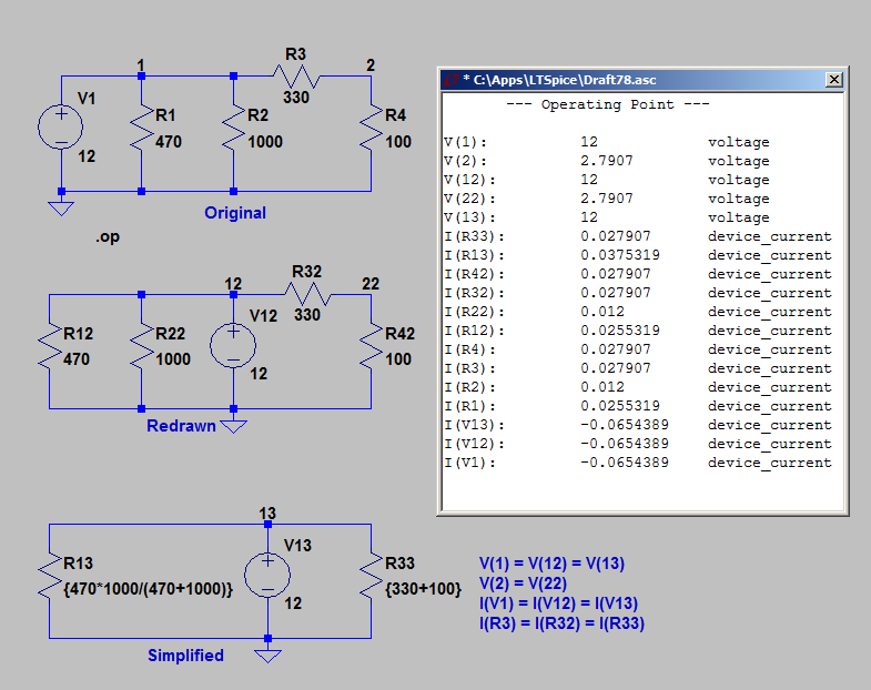

I have always had a bit of trouble understanding KVL. In the attached image I need to measure all of the voltages in the two loops and confirm that
KVL works. I simply can not get the math on this one...can anyone help...the suggested solution is below?

dk: The 1K and 470 are directly across the source, There is nothing in the statement of the problem to indicate that the current out of the 12 V source is limited, so those resistors do not affect the voltages at nodes 1, 2, or 3 in any way.
GBB: The equation and solution are correct. What is it about the solution that you don't understand?

The three steps to solving this: If you really want to apply KVL, apply it to the "simplified" version of the circuit so that you have two meshes. The DC analysis shows that the three versions of the circuit I show below are topologically equivalent.

Kirchhoff's voltage law (KVL) states that the voltage drops across each component in a circuit loop are equal to the source voltage. You do not need the voltage divider rule to validate KVL. Only the rightmost loop with the two resistors are relevant to this problem. Using the definition of resistance, it can be determined that 12/(330+100) =0 .027907 amps of current are present in that branch. Since the resistors are in series, the same current is present in both resistors. So if we figure out the voltage drop across each resistor and add the voltages, we should get a total of 12 volts, right? The voltage across R100 is 100*0.027907 = 2.7907 volts. The voltage across R330 is 330*0.027907 = 9.2093 volts. Adding the voltages of the two resistors we get 12 volts. That shows the sum the voltage drops across the two resistors is equal to the source voltage and validates KVL. Any questions?
Ratch
Notice: This validates KVL, but it does not prove it. We used specific values of voltage and resistance. A real proof would use a general voltage and components. Otherwise, a pedantic person could say that it might not work for a different set of values.
