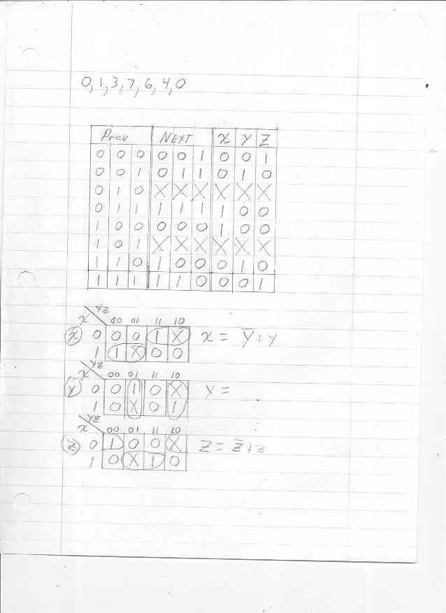

i am trying to get three leds to count a sequence useing combinational logic. i will be useing three jk flip flops. the problem i am haveing is that i dont understand what to do when everything cancels out on the kmap
I have posted several items on the design of counters using JK flip flops. Try this one for example. https://www.electro-tech-online.com/threads/kwh-meter.8219/
Your K maps don't make sense. Read the above post and then ask questions if you don't understand it.
You could also do a search using me as the author and flip flop as the subject to find my other posts.

Your "previous and next" table is not clear. That is why you could not construct k'map.
Check following, is this what you want.
x=y
y=z
z=x-bar( ie if x=1 then z=0 if x=0 then z=1)
