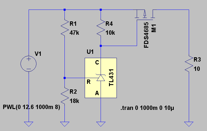

I am into RC trucks and in my current project I need a low voltage cutoff circuit.
I am using 11.1v lithium battery (3 cell 1500 mAh) so they can be damaged when voltage drops below 9v or 3v per cell.
So I would like to make a circuit that I can hook in between the battery terminal and the truck connector so that when the voltage drops to 9v the truck turns off all together.
to cut the power to everything connected to the battery.
If possible maybe have it beep a few times before it cuts out completely.

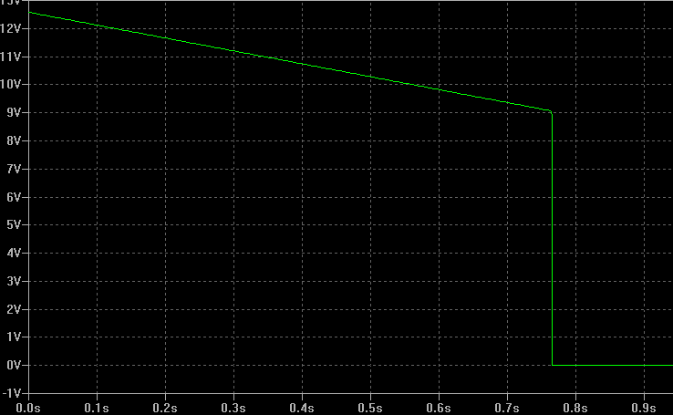

Hi Brian,
Here's a circuit that will switch the power off when the voltage
drops below 9 volt. It's as simple as I could make it but there's
no buzzer. It uses cheap and readely available parts so you can
obtain them from a local supplier. The only somewhat difficult
part is the P-channel mosfet, select the one with the lowest
Rdson available.
This circuit is easy to build so you can test it and see how it
behaves. Later you can substitute the TL431 with a ICL7665S
and include a buzzer.
on1aag.

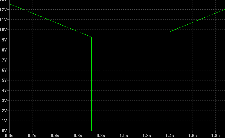

How did you draw that schematic? did you use a program?
It looks like in the pic of the graph that you where able to test it is that so? haha

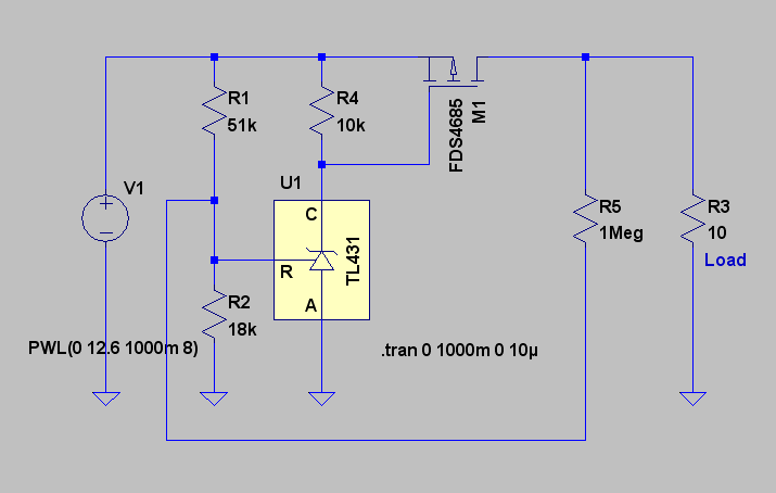

Hi Brian,
If you take a closer look at the datasheet of the ICL7665S
you will find examples on how to design similar circuits.
ICL7665S*CMOS Micropower Over/Under Voltage Detector
The simulator, Switchercad, can be downloaded here:
Linear Technology - Linear Home Page
But you might want to search the internet to find some
extra simulation models.
Start with the simple circuit and test it.
Then you'll know if a hysteresis is necessary or not.
Perhaps you can use it separately for the leds and the
smoke generator.
With a slight modification you can add a hysteresis.
on1aag.

ok so I notice you put in one more Resistor R5
is that the hysteresis?
I am new to that term ?
I notice also that the voltage drops to 0v then turns back on at around a little over 9v.
is that so that it will turn back on once It hits that voltage and that would mean a new battery or fresh charged battery?

Leds operate from current, not voltage. So you must use a current-limiting resistopr or circuit in series with them.
You probably have a 3-cells Li-po battery that is 9V when discharged and is 12.6V when fully charged.
Then you will see the LEDs dimming if a resistor is used.
Alright, I guess I got hung up on the fact that they have a max V in the datapages I was looking at. My plan was to have a fixed volt output, say 8v, thats enough to fit roughly 2(or more) of any colors in series with resistors, atleast of the ones I looked at (2-4v spanning red, white, blue and green). Should that not keep the diodes shining bright untill cutoff, because I calculated the resistors based on 8v - which is available till the very end?
But my basic problem still is I can't see from the diagram he drew where I connect my LED's(with resistors) :) I'm likely missing the obvious, but if someone could either draw on the diagram or point out where (so I get the cut-off effect), I'd be very happy :D
And thanks for the answer :)
I caught as much. But that says nothing(to me) of where I connect the LED's. Not sure how to explain it clearer. Where do I connect the + and - of my LED? (assume the resistor is there).
Your LEDs and current-limiting resistor are the 10 ohms load resistor in that circuit. Your battery voltage will drop to about 9V when the LEDs should be disconnected by the Mosfet.
