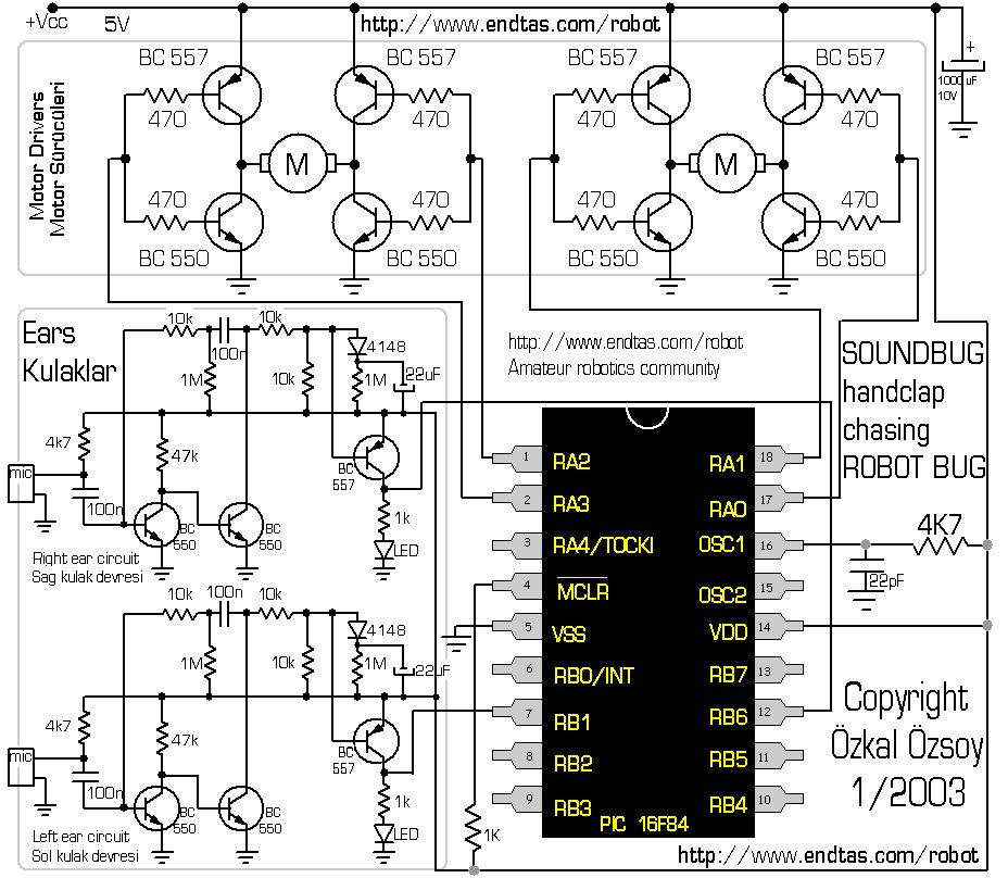

can please someone direct me why this Mic amplifier does not work?
i can not assume any error with it but it does not work :cry:
There is no bias stabelization in this circuit. One or more of the transistors is saturated or cutoff, very bad design. You could make it work by trimming the resistors so that all the transistors are active but much better to use some feedback.

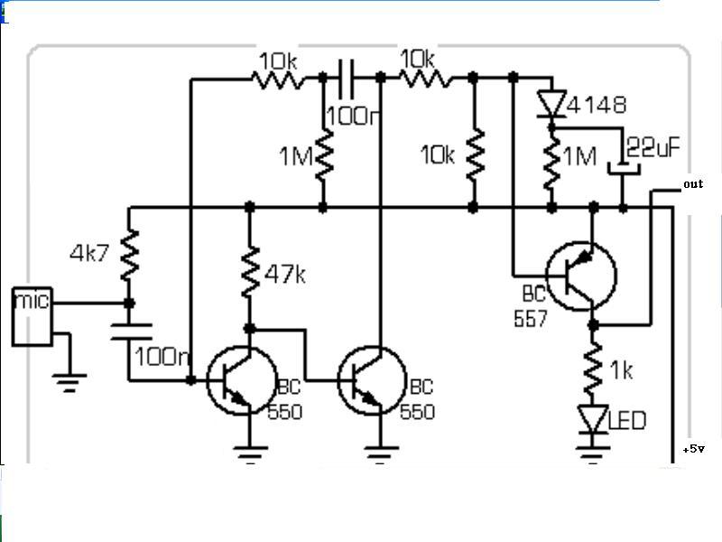

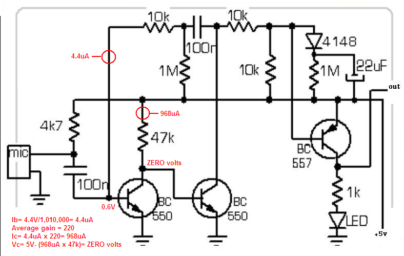

The BC550 transistor and just about any little transistor has a current gain from 110 to 800.
The original circuit won't work with any of them and here's why:

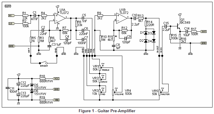

Hi Dr. EM,
Since you like Rod Elliot's designs, his Guitar Amp MkII project is good.
The schematic of his preamp is here:

It isn't really a "microphone preamp" circuit. It is designed to respond to loud hand-claps. If the gain of the 1st transistor is too low then it will get cutoff by a loud sound, the 2nd and 3rd transistors would conduct then the microcontroller would get an input.
The 22uF cap near the PNP transistor doesn't do anything since it charges during idle then the diode is reversed during a loud sound signal.

finally i built the WHOLE circuit today with the original preamplifier circuit
and such as i thought it did not gave me a good result..
yes this is a "sound sensing bot", here is the link:
https://www.endtas.com/robot/modules.php?name=News&file=article&sid=29
the problem now is that i have some of unwanted signals that cause the PIC and motors to start without any sound or even without the mics mounted on the circuit..
i am sure the problem is from the preamplifier circuit, the inputs of PIC(7 & 12 pins) need for a positive signal to be actived and if i cutoff the preamplifiers output traces then the unwanted signals would be lose and the inputs of the PIC will be waited to get a positive signal,for example if i cutoff the outputs of preamplifiers the motors stop runing even i put a wire from the Vdd to the inputs of PIC.

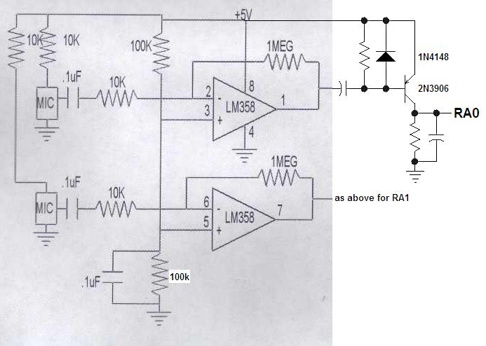

i used from this dual preapmlifier too but this time the inputs of pic could not be turned on(be actived) i put the output of this circuit dierectly to the inputs of pic alothough i used from a 22uF cap at the circuit ouput too but the circuit output could not make the inputs of the pic actived.

Your good but fairly noisy dual mic preamp probably needs mono-stables at its outputs to give long-duration pulses to the pic so it can "hear" it.
Did you use two-wire electret microphones? 3-wire ones won't work in that circuit.
Did you connect the mics with the correct polarity? Their case should be grounded and the other wire is their power/output.

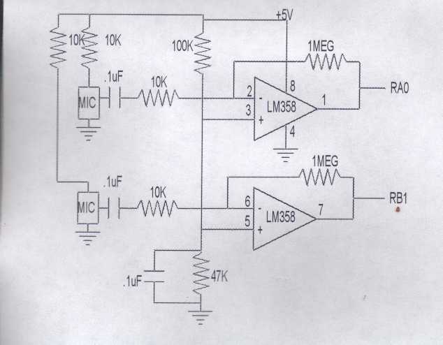

Hi
it is enough a short time positive circuit and the pic provides a few(one or tow seconds)of duration by itself.
although i dont know what is the philosophy of 3 wire mics than the 2 wires but i used from 2 wire mics too and the 10k positive resisistor went to the 100nF capacitor(input of the mic)
yes i know taht the case is grounded....
since i needed for a positive sugnal so i thought perhaps the output of lm358 IC at the above circuit become low(-) with the sound but i think this guss is not true.
The output of your mic preamp fluctuates positive or negative from its idle 1.6V voltage at the frequency and level of the sound. With a loud sound it would alternate highs and lows at the frequency of the sound. If it had a rectifier and filter cap on its output like the original circuit tried to do except its rectifier was backwards, then maybe the pic would hear it properly.

can you show me the whole circuit with the Lm358 IC that does work?
i do not know from which kind of the original preamp circuit the glitches was generated really
i wish someone have built this and could help me for a direct.. circuit
Maybe this will work:
