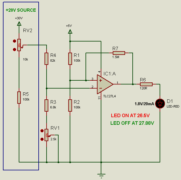

Hi Cory,
using a TLC274 you can monitor four voltages.
The trip points for the LED are: ≤26.5V = ON, ≥27.88V = OFF.
You might adjust for your requirements using RV1.
Boncuk

Good example Boncuk, but why the complex divider made up of RV1, RV2, R3, R4, & R5, when you can do it with just 2-3 parts instead of 5?
Good question. :)
You may have noticed the blue frame around RV2 and R5. This is the simulated 28V (to 30V) source which is not part of the circuit.
Doh! :eek:
