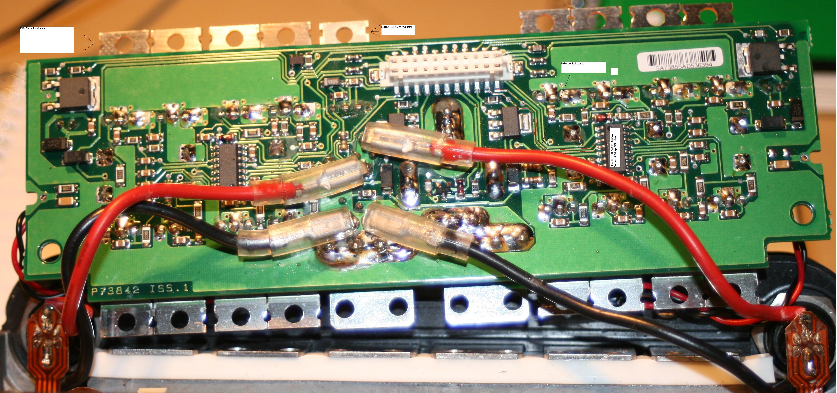

I have an old F11 electric wheelchair, i was originally trying to modifiy the joystick that controlled the motor controller. but that dream went out the door, when it burnt up. so ive been working on controlling the original motor controller, since i dont know how to duplicate the serial commands it used from the joystick, i found that it used 16- F1010N triacs, and 2 HIP4082 h bridge controllers to run those, according to the data sheet the HIB4082 seem to use a PWM signal to run the motors, what im wondering is can i solder leads on to the 2 pins that control the PWM on the chip and connect it to a PIC micro controller or even better would be if i could hook it directly to an RC receiver and send commands to it. (i would really like to run it right off of an RC radio.

Pictures would really be needed, I don't see why you couldn't tap into the existing motor controller as long as you're sure it still works, it should be pretty simple, though I'm guessing you'll need at least a basic external driver circuit from a PIC to drive it, if nothing else to adjust voltage levels. When you take pictures make sure you get good shots of all the IC's on the board or label the picture somehow and type the chip numbers out in text with the post. And post a link to the PDF.

The motor controller had a daughter board attached the ran everything, it accepted the serial commands and converted them in to the driving singals. i did manage to trace out the pins to the chip, that are marked pwm on the data sheet, and they go directly to the connector that daugther board was connected to, all the other components and power needed for the driver chips is still handeled by motor controller.

Pictures of the motor controller top and bottom, i labeled the back view picture, you need to zoom to see the labels came out alittle smaller then i was thinking but there are very clear when zoomed.
The 16 transistors, are F1010N, the 2 motor control chips are HIP4082IB, there is a single transistor that serves as a 12 volt regulator.
I tried hooked my rc reciever directly to the pwm lines for the motor controller but only registered a change of 1 or 2 volts on my Multimeter.
i think it might need to be applified if i read the data sheet correctly around 15 volts ?

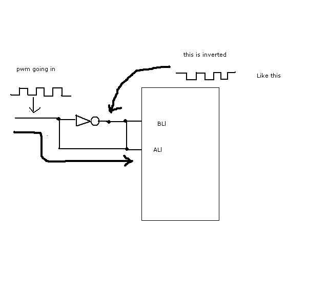

Are you using the same pwm for bolh BLl and ALl you have to invert one of them I drawled it out for you :)

ive been looking for more information on this i think i found one circuit that may do just what i need.
Other then that i have no idea how to invert the PWM signal for the second pin on the H-bridge.
any thoughts ?
Yeah... Use a logic inverter?
Try looking this stuff up on Google, it's all out there in black and white =)
You can use a single transistor or mosfet with a resistor as an inverter. Or better yet, buy a real inverter =) They're dirt cheap basic logic IC's available many places.
You can make one easy but it takes 4 transistors to make what he needs. So I would just
buy me a 29 cent hex inverter and be done with it.
