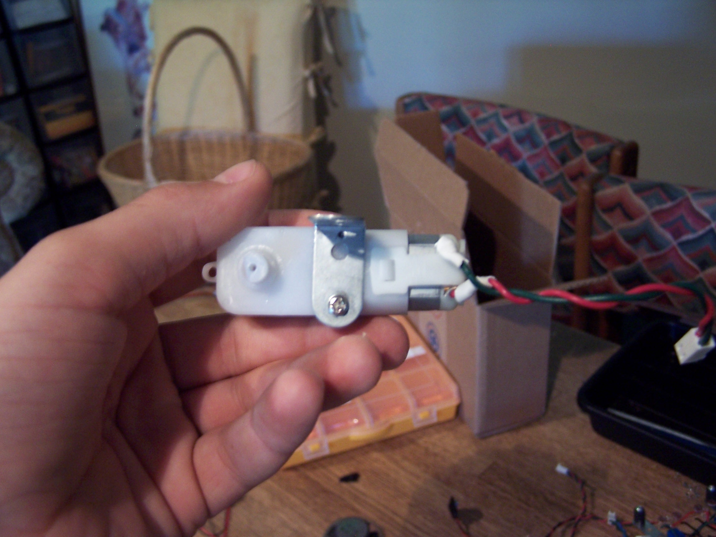

I wanted to drive 2 motors that run on their own power supply. I was wondering if i could use 2907A PNP transistors to run them, or would I need a MOSFET? The control current would run to base, and it would be isolated. But i need to know how to control it on its own voltage/power supply. I have tried this with transistors, but it doesnt work. Anybody have any ideas or suggestions?

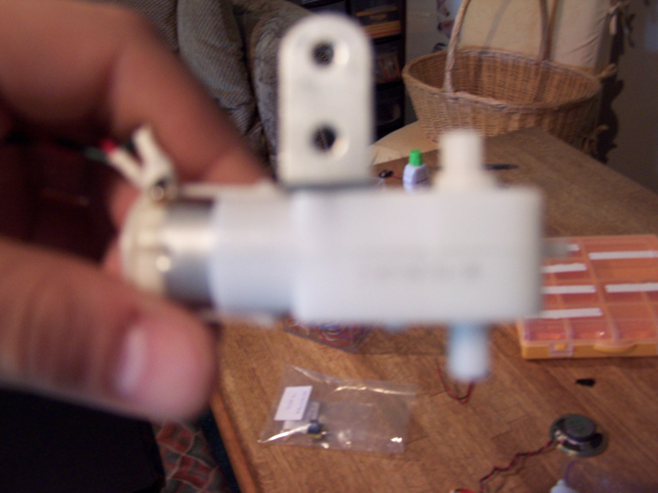

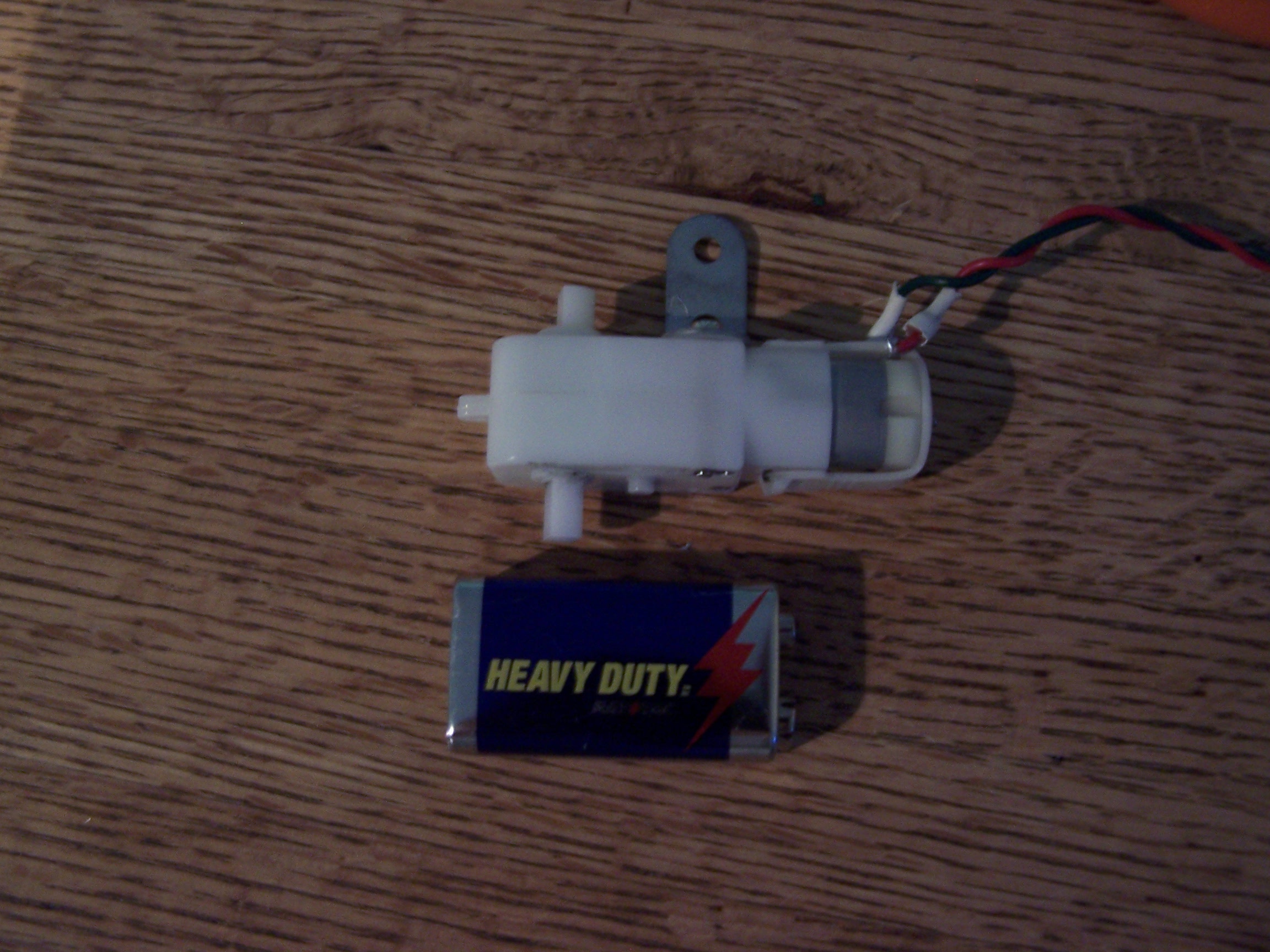

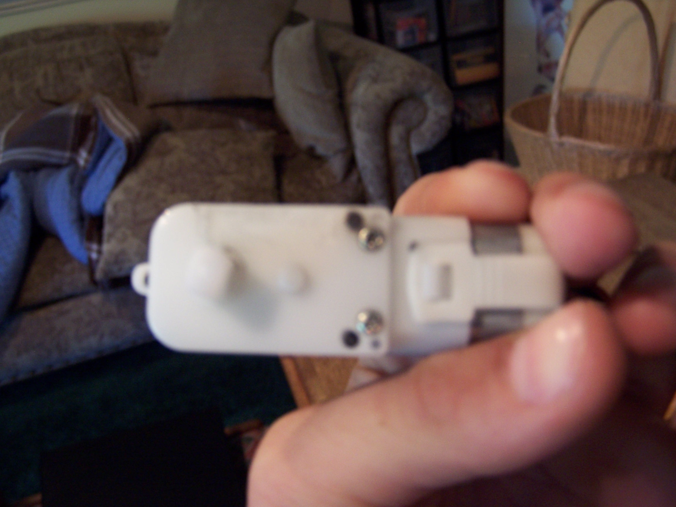

ok here are the values for the motors, but please read the note below too.
Voltage- 6v
mA use unloaded at 6v- 35mA
Stall current at 6v - 639mA
*BUT*
I am also willing to use MOSFET, or whatever cheap solution i can use to power my motors. also, it must be isolated from the circuit; the motors must be on their seprate and very own power supply.
ALSO: i can supply these motors with voltage between 3v and 12v. the 3v specs are listed below:
Voltage- 3v
mA use unloaded at 3v- 23mA
Stall current at 3v- 389mA
AND
I require no motor reversing, speed contol, or other fancy smancy stuff. I simply require some straight moving motors!
I also want to use them with AA size batteries, and I think thats all I need to suggest.

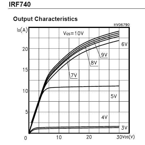

Most MOSFETs can pass small currents at low gate voltages. For example the IRF740 can pass 1.25A if the gate voltage is 3V. The moral of the story is look at the datasheet.

Another gross over simplification.
The datasheet shows its max threshold voltage is 4.0V where it conducts only 250uA. They have a range of threshold voltages, you can'y buy "a very sensistive one".
International Rectifier invented the IRF740 Mosfet and their graph starts with a gate voltage of 4.5V where it typically conducts only 0.6A with a whopping 0.6V saturation voltage.
With a 10V gate voltage it typically conducts 1.4A with a 0.6V saturation voltage.
It is a lousy Mosfet, maybe because it is rated at 400V.
