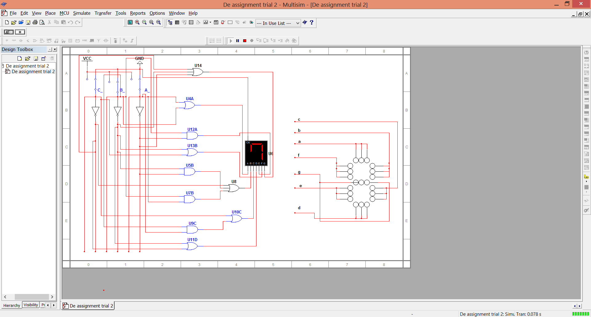

Hi its my first time using this forum. I have just entered a engineering course . Its my first year and I have my first project.
It is said to design a octal to 7 segment LED decoder using the common cathode. Simplification using Boolean theorems and K maps. I only need to start from digits 2-7 using the least number of gates.
After that using NI multisim to show my answers. I have done everything just that I am not sure on how to use this program.
I tested out the circuit in the program and its shows 7.
May I know if it means I am right? Or how do I further check my answers..
Please take a look at my file
Many thanks in advance
Attached is the file
Testing only one digit does not prove the circuit works. To prove that you need to sequence all the digits 2 through 7 and see that the display shows the correct output for each digit input.
