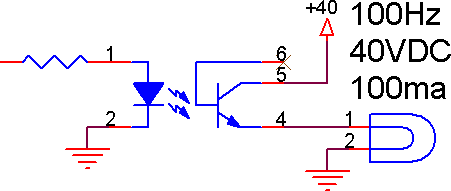

Attached is a schematic for a high side optoisolator. I've not used optos often enough to know if one exists that can take a 10ma input signal (the led) and supply approx 100ma to 200ma at 40vdc max @ 100hz (I've used some SLOW optos before and they are SLOW...)

Current Transfer Ratio
The specification you are looking for is called the Current Transfer Ratio, or CTR. A typical CTR value for a 4N25 type opto is 30% to 600%. You can specify a CTR range when you buy them and the higher the CTR the more expensive. They won't quite get to a factor of 10 and they degrade with age so you really can't depend on the CTR remaining constant.
When you say they are slow I assume you mean propagation delay. They are in the 3 to 5 microsecond range. If you want low propagation delay try the HCPL 0710 at 40 nanoseconds. Of course you will pay for this feature.
why high side? isn't that basically an emitter follower?
I'd use a driver transistor but you should figure out the power dissipation, I think you might be pushing it with a small signal transistor.
