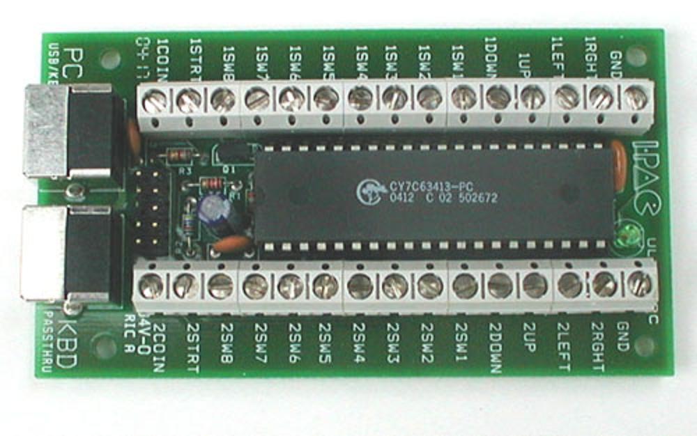

The Ultimarc controller which does everything I want or more really than I need looks like this.
The chip it uses is the Cypress CY7C63413C, the link takes you to the data sheet.
Again, I don't have to use this chip, any PIC that will work I'll use. I was just throwing it out there, by the way, it only cost $3.00 usd so thats good.
Thanks!!
Below is an up close pic of the I-PAC2 encoder board with that chip installed.

That was my plan but I am trying to get my production costs down. Keep in mind I will be making at least 100 and probably more.
It doesn't seem that is would be that hard to just program a PIC to do the same thing.
If I use the Ipac I have a few problems. First it would not fit in the case hand held case with the rest of the electronics so I would have to put it at the pc end. So I would need another box enclosure.
That would then require at least a 21 conductor cable between the hand held box and the box containing the ipac board.
Also there is no way to professionally mount the board so the the PS/2 ports are clean and flush against the case.
There are other issues as well that I can get around if need be but because of the added parts and time it would take to setup it really pushes towards using a PIC mounted directly on the PCB in the hand held device.
Not to mention IPAC does not allow there boards to be using in any device that will be redistributed.
Thanks though, I agree and thats what got me started in this whole thing was finding the IPAC lol. However, I know it could be done with a PIC I just don't know how to go about doing it.
I forgot to mention that I will have to have a PCB board made regardless. The handheld device will contain a joystick and many tactile type switches that must be attached to a board for stability.

Some comments.
Neither USB nor PS/2 keyboards send ASCII. PS/2 keyboards send make-break codes, also known as scan codes. The scan codes can be multi-byte. If I recall correctly, USB keyboards send a packet of key codes of all keys being depressed. They send a new packet (on request) when the configuration changes.
How many switches are there? You will need to debounce all of them at the same time.
A PS/2 keyboard uses open-collector outputs, so you can hook in with similar outputs. As for needing a software upgrade for USB, I assume the software developer has not been developing for Windows 98 or later? Or are they writing firmware?
The PIC 16C745 is old and inconvenient, as there is no Flash version. There are a number of USB PIC's in the 18F series. Any PIC that has enough code space will do for PS/2.
