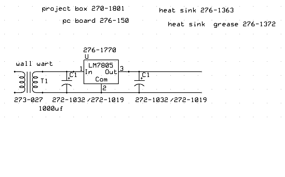

I'm in over my head, I built a train table for my son and I bought a kit to supply train sounds. The kit is battery powered, 2 AA batteries, but I want to connect it to the power supply from the model train transformer.

I was told that I could use an LM7805 voltage regulator to run the sound board on the model train power supply? Will that work? If so, how does it connect?

Read the LM78L05 data sheet (**broken link removed**), and write back if you still have questions. Use the one in the TO-92 package.

the 7805 is a good choice of regulator to use, but you need to think about the power you are going to be dissipating in it.
The input to your 7805 is 17V and your output is 5V. This is 12V across the component. With a current flowing through it of 0.23A, this represents 2.76W.
Anything over about 0.3W and the 7805 will start to get hot
Personally, I would use a separate 5V regulated (and it must be regulated) wall cube power supply (a plug with the power supply built into it)
You could also use a 3W series resistor to drop some of the voltage (about 40 Ohms) then this will share some of the heat between the resistor and the 7805
this should get you started

as mentioned the leftover power 17v - 3v has to go somewhere.
here we are starting out with 9volts reducing to 5 volts.
Radio Shack has a 4.5 wall wart but then you can't use the 7805.

The OP said the max current of the sound circuit is only 0.23mA, not 0.23A.
So the little 78L05 will dissipate only 3mW. Its idle dissipation without a load is about 65mW.

Just get a cheapo 5V wall cube. The sound card doesn't need perfectly regulated DC, if it did the VIN range would not be so wide. You could get a 9V wall cube and feed it to a 78L05 for a regulated supply, but I doubt it will improve performance.
