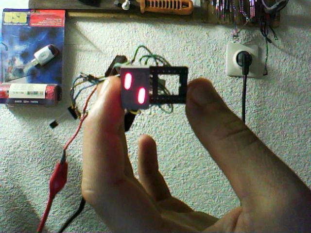

Heloo again
I can programm the PIC16C84 with no problem,but when I try to programm PIC16F84A I recieve mesage verify failed at 0000h,I built the thermometer with PIC16F84A but because I cant programmed I use pic16c84,and thermometer works but led displey work with mistakes(the conections between pic and led displey are correct).
Sorry for my bad english
here is some pictures
regards to all
The SSD LEDs look reversed (what's on is supposed to be off and vice versa). This can happen if you write code for common anode SSDs (where you need a logic level of 0 to turn on a segment) and use common cathode (where you need a logic level of 1 to turn on a segment) - or the other way around.
