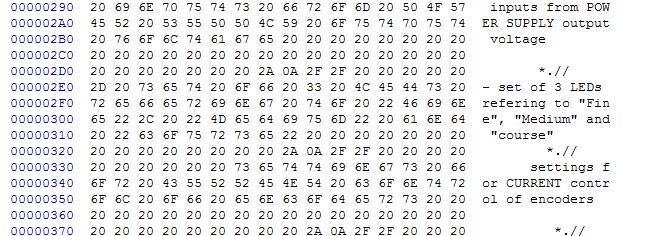

Why am I getting no carriage returns in that code? Totally unreadable for me.
hi M,
Confirmed that the 0x0D is missing before the 0x0A in the hex code view of that listing.
E

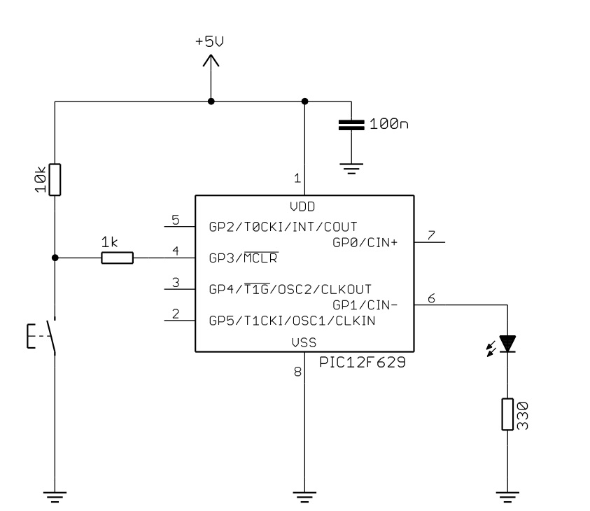

Hi There,
I have been using the Gooligum tutorials as a basis for using a button press (circuit included). I have also included an updated program. I have loaded the program into the micro controller and it runs however it immediately detects that RB1 is low and goes into the function where it never leaves as RB1 never registers a high (i.e release of the button). the button is never pressed as RB1 appears to be sinking the current. I have used a multi meter and with it not connected to RB1 it registers just under 5v on the jumper (not connected) and when the button is pressed it duly goes to 0 volts. So I believe that the circuit is correct but that my program is some how making RB1 sink current all the time...
Is there something I am missing?
Kind Regards
Simon
