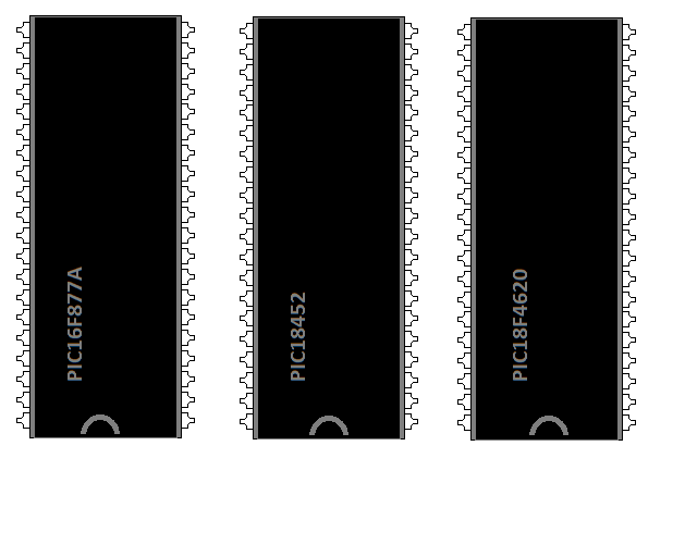

Three chips I've used for the same job..... Pic16f877a 8K Code, 368bytes Ram, 256bytes NV Ram... Had a decent working unit..
Needed to upgrade... Pic18f450.. 32K Code, 1536 bytes Ram, 256 bytes NV Ram...
Needed to upgrade... Pic18f4620.. 64K Code, 3896 bytes Ram, 1K NV Ram...
The point is, the units are pin compatible... If you change the hardware along the line you can change the micro.. If you just need more space, then there will be a bigger chip..

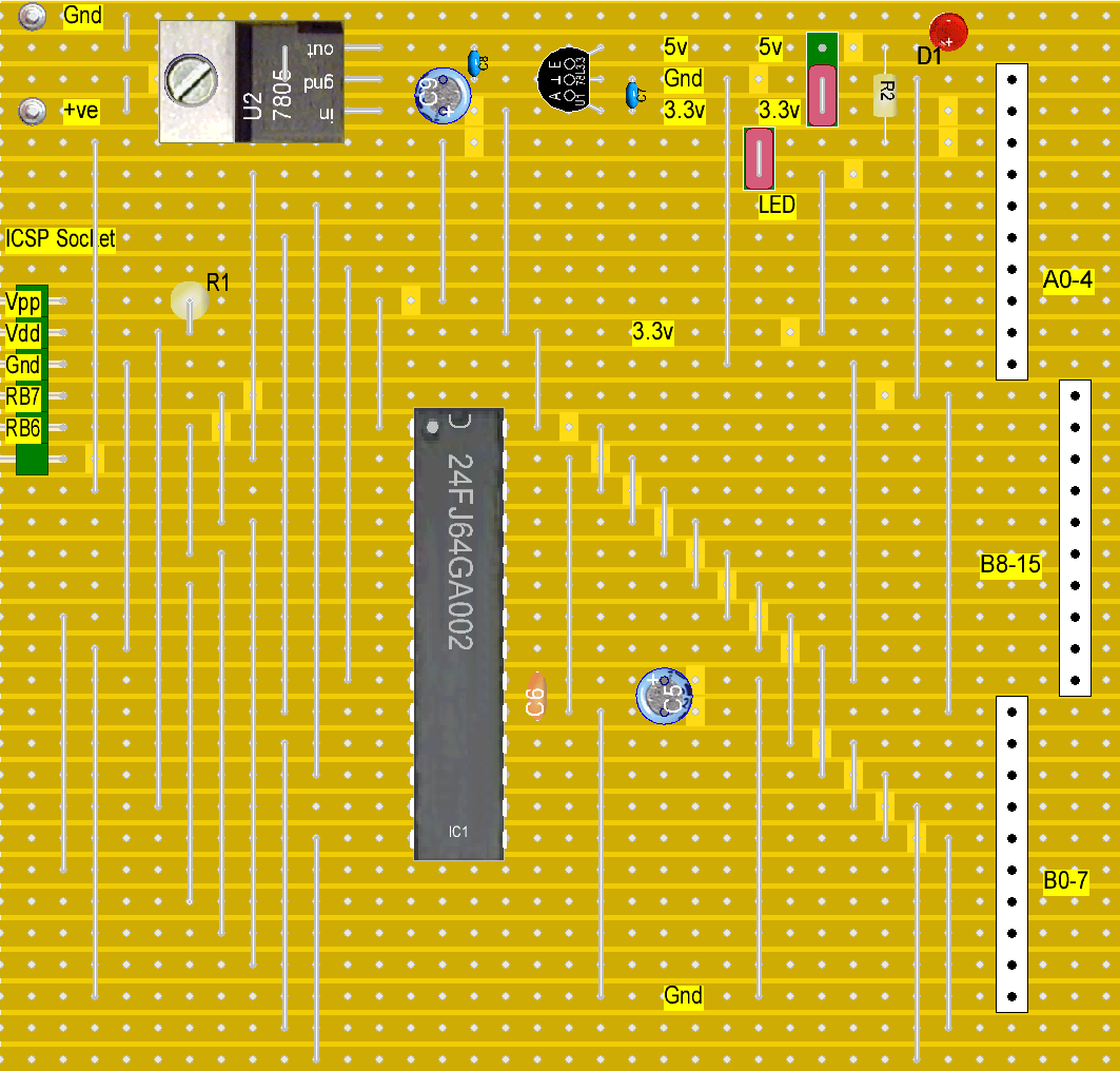

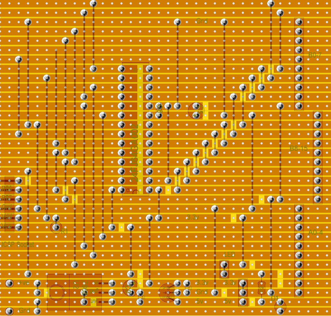

I've recently (this week ) started playing with the PIC24/33/32 series - but mostly the 24. I've bought a MicroStick II which comes with four example PIC's, two 24's, a 33, and a 32. I've also built a further board for my tutorial series, and bought a few 24FJ64GA002 PIC's to play with.
All these PIC's have internal oscillators, avoiding the need for a crystal - unless you need high accuracy, and all are pin interchangeable.
Here's the design of the board, it incorporates a 5V regulator, and a 3.3V regulator (to feed the PIC), the power to the three sockets can be selected with a jumper as either 5V or 3.3V, and there's an LED (connected via another jumper) fed from the same pin as the MicroStickII board - so you can use the demo program that comes with that unit.
