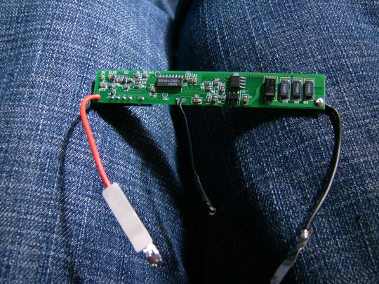

Well, I received the batteries today, plugged them in after testing each.
Tested that every connection works, the whole battery pack is intact electrically - but the laptop does not see the battery pack. I guess I threw $50 out the window =(

Well, as the OP didn't posted any photos of the evil control circuit I decided to find one. The resolution is crappy, but it gives you an idea of how hard will be reseting it.
This is an opinion from an instructables guy:
"That little board you wired up the new cells to is very picky and designed to kill the battery all together in most cases of any kind of tampering because of how volatile Li-ion cells can be. When replacing the cells it can sometimes take 2 or 3 charges before it gets back to normal. But as long as the voltages are the same as the OEM one it should "work" but the computer may not be able to see the charge level and may not be able to charge it at all."

No, the problem is not the PCB, is just doing its job :)
The idea here is reseting it, look

Hey guys, sorry for not providing any pictures. I will take a few snaps as soon as I get my hands on a camera (should be tomorrow).
Just saying, the board is not like the one found by Menticol.
i dont think it could be reset because the chip has memorized the condition and it has shut down as a precautionary measure.
But there might be a way to bypass the chip.

All the components are soldered to the PCB without the batteries so they must set the protection IC up then.
If he knows the part number for the protection IC, he'll probably be able to find the datasheet which will have the reset procedure.
I got some pictures using a lens and my girlfriend's iphone.
I hadn't had time to take out the board (and it's held inside by something resembling white hotglue). I will do so once my midterms are over (this weekend or earlier).

(EDIT: I have no idea about Microcontrollers, this is just a guess, correct me if I'm wrong)
A protection IC? I don't think so, maybe is a simple microcontroller that does everything:
1) Microcontroller read's the memory
2) If memory says it's OK, the microcontoller triggers a transistor and the current starts to flow towards computer
3) If memory says VOID or OVER-DISCHARGED, the transistor is not triggered, battery keeps dead.
Jumping the transistor is not the solution, because the charging program may be also coded on the microcontroller. Charging the battery without the program and temperature monitoring may cause overheating and exploding.
