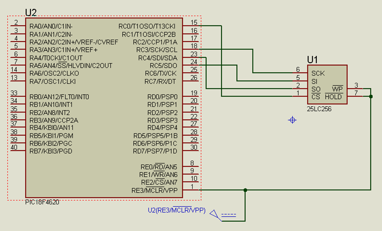

attached is the schematic.
Are you sure that the data comes back at the same time you are writing the low order address in the read routine?
Why are you using `int' variables when in all probability SSPBUF is byte wide register?

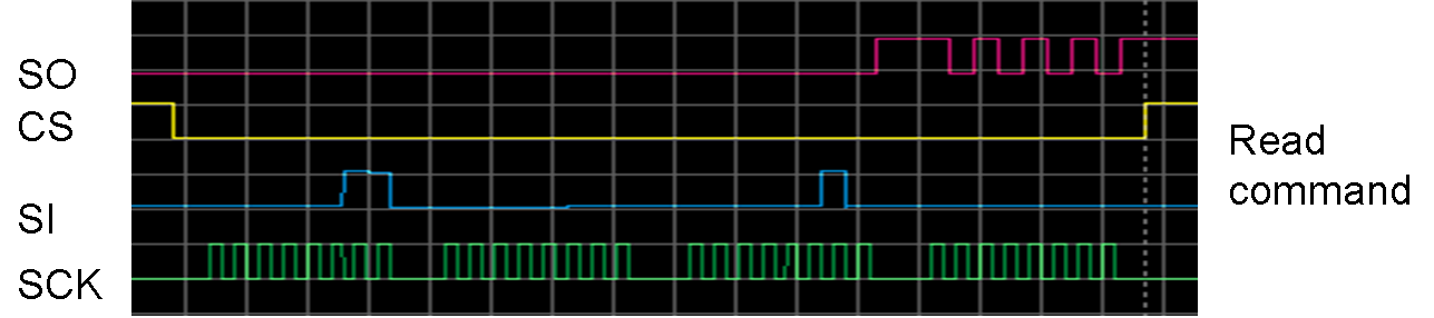

Hi..
I have spent hours and hours looking at the datasheet and trying to understand the waveform..
Finally i manage to get the correct reply from the eeprom.. I sent "0b10101010" to the eeprom (in Proteus) and when I monitor the signal using oscilloscope, i can see "0b10101010" from the eeprom..
However, when I check the SSPBUF register, it remains 0. Can anybody please help me with this final step of how I can receive the data and store in a variable..? By the way, I am using Microchip C18..
Below is the complete code and attached is the signal showing the whole read sequence.
Oh.. by the way, in the picture, the MSB of the SO signal looks weird.. It is suppose to be 0b10101010 (8 bits) but it looks like 0b110101010 (9 bits).. Anybody knows why it is that way..?
Thanks..

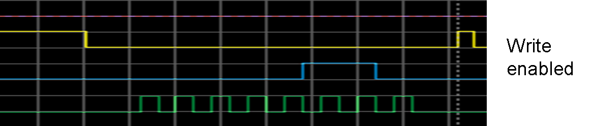

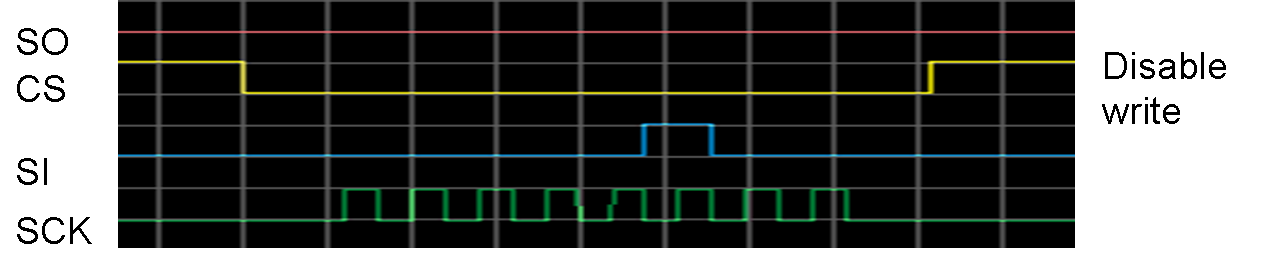

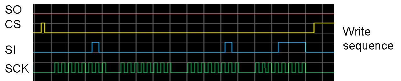

Oh.. by the way, below are the rest of the waveform for different commands, for those who are interested.
