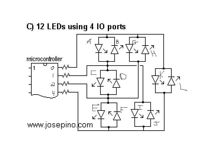

ty AllVol for your help is there any way to Simulate the code using MPLAB since I do not have the programmer it is at the school witch is closed for the summer is there a way I can run the code and see the outputs if they are high or low I have tried looking on Microchip's website but can't seem to find anything about it and I will probly loop after a few times so that I will not have to keep repeating the code over and over again also im unsure of how to change a pin to be a input while keeping the others as outputs I was looking at the Micochip Tips and Tricks thing you gave me and it shows that one pin can be a input while another pin a output also when ever I quick build it I get the following error every time I don't know what I did wrong
And after that just to clarify things for Multiplexing 12 LED's using 4 pins it would be as like this the image I based my chart off is the attachment
Pins then the LED's that are on
GP0 GP1 GP2 GP4
1 0 0 X A
0 1 0 0 B
X 1 0 X C
X 0 1 X D
X X 1 0 E
X X 0 1 F
1 X 0 X G
0 X 1 X H
X 1 X 0 I
X 0 X 1 J
1 X X 0 K
0 X X 1 L
Assuming this is correct then this code should turn on LED A for .5s then turn it off ( The reason im doing it as subroutines is that it makes the code easyer to understand bc all it does is call the subroutines so that I can make any pattern without having to type alot of the code over again I can then just loop the calls to make a pattern
This is the full code and quick build im having some problems with it

Three errors in your build ---not bad! Here's a little trick I use for error control. While on the output box (where the errors are listed), if you double-click on the error itself it will show you the exact line containing the error. You will see this on the editor page. If it's something you can fix immediately, do so, then compile again. (F10). Do it one error at a time because some times, fixing one error will take care of a bunch of others. If you get an error you just don't know what to do, try commenting out that line and then compiling. The object is to get a build that succeeds, so you can then work with the debugger. (Hint on the lightled1 error: Try putting it in the left-hand column to itself)
Try this, and let me know how you make out. Then, we'll get into the debugger part, if you're ready.

Your code is written to use a linker script but you haven't included one in your project. I would suggest you just use absolute code (without the linker script) for now. You also have a few errors in your code, you have GPI0 (zero) instead of GPIO (letter O) and the end directive needs to be at the end of your code.
I took the liberty of tidying it up and getting it to compile.

This is the Switch Code that ive been working on it enables me to have the cycle subroutine loop on pin GP3 when the switch is pressed and have the Random subroutine loop on GP5 when the second switch is pressed now this is my first project with the PIC's and coding them I just learn things really quickly is this the correct way of doing it or is there a better way ? Im posting the whole code so that everyone whos currently helping knows the subroutines since I contiune to add too them :D
For the Rain part it will just be a combination of all the lightled subroutines and will start at the top and go to the bottom of a cube it will look amazing just have to add delays and such so it looks a little random and will have to make it work with all 4 of the 509's but that shouldn't be too hard I already have the basic layout of the cube and a graph to show what pins need to be turned to what for each LED and I have also changed the subroutine names as well to letters instead of numbers since the scymatic I drew up makes more sence that way then with numbers
Srry updated code there where a few errors in compile that I saw and fixed as well as I updated it wit some of the Ideas I had with a new Cycle subroutine and a Rain subroutine how do you guys like it anything I can do to improve it maby change some of the delay times but I keep adding different effects in every time I work on it so ya how would I go about getting a 5s delay could I just use the delay10 and repeat this as shown below this would be for 1.5s
movlw	.5
movwf	delay10
movlw	.5
movwf	delay10
movlw	.5
movwf	delay10
Once again updated code but for some reason the debug is not stopping at he switch its going stright too the Cycle Subroutine

;************* Subroutines
;****************** LED Subroutines
lightledA
		movlw	b'111010'	; Configure GP4 and GP1 as input
		tris	GPIO
		movlw	b'000001'	; Change corresponding bit of GP0 to 1
		movwf	GPIO		; Writes 1 to GP0
		movlw	delaytime		; Get from dealytime variable
		call	delay10		; Delay of 50 x 10ms = 500ms or .5s
		movlw	shadow	; Change corresponding bit of GP0 to 0
		movwf	GPIO
		movlw	b'101000'	; Configure GP0,GP1,GP2,GP4 to outputs
		tris	GPIO			; Write 0 to GP0
		retlw	0
