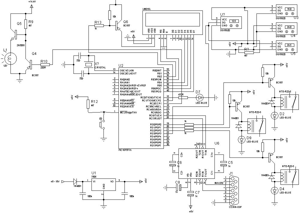

hello, I can help me with a project?
I want to make a minicomputer for my car and have the following functions
1. Water and oil temperature
2. Temperature inside the outside
3. 3 release of the order to relay a command electroventilatorul
4. Ceiling Ordered to Dimmer button doors
5. Contrast automatically display based on light
6. Tachometru
7. Mileage
8. Litrometru for reservoir
9. Flow meter for carburetor
10. A menu command for all the above
I use a 16F877A, that has two hardware PWM good DIMM.
a 16x2 display and the sensors DS18B20.
First I tried to start in proteous sensors, but I do not know how to start with the drivers. I did not read any temperature.
I know that the project is quite complex, and are at the beginning we never programmed PIC's, but I think with your help can be achieved.
Below is attached blueprint of the moment, and still missing many, but I come to ask, or if you have any ideas please help me
Excuse my poor engleaza
Your blueprint does not show. Please use "attachments".
Do you have a program running on the 16F877A? Do you have the display working?
Look blueprint and is not finished, there are several modules to implement.
Yes, the display is functional, can afiez text.
I thought to start the project with the temperature and then the restu and finally to solve and the menu and save in microcontroller.
I still think about how to make modules, each module to have in hand in a librarry
Ex
menu.h
menu.c
temperature.h
temperature.c
dimmer.h
dimmer.c​
This page has assembler code and instructions for using a PIC16 with the Dallas 1-wire interface (which is what the DS18B20 uses) -
I do not know asm,
C source?
I think we need to be a source of read sensors and one source to convert temperature
I do not know asm,
C source?
What C compiler do you use? The mikroC and CSC C both have library functions that communicate with both i2c and 1wire sensor devices (mikroC have closed source libraries, CSC C have visible source libraries). I believe boostC also have library functions for communication with these devices. DS18B20 is 1wire and you will find examples on how to use it with both csc c and mikroC. If you use some other compiler, please let us know which one so we can be of more help.

i use CSC C and mplab IDE
how to enable the output oscilator? i want to use a cristal quart oscilator
i have try this cod for now, but nothing......
the read is 0
where is wrong?
