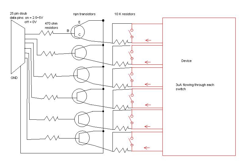

Hi there. I'm designing a circuit so that I can control 6 switches of a device using transistors and the serial port on my computer. I have 6 data pins going into the base of 6 transistors. The positive end and negative end of each switch is going to each collector and each emitter is going to ground of the serial port. Basically, when the data pin is on the transistor draws current from the device to the ground of the serial port and the switch is off. When the data pin is off the transistor has high impedence so the current goes through the switch instead and it is on.
I have found that this works for just one switch but not when I hook up the others. I have a theory that too much current is being drawn from the device to the ground of my serial port for one switch and not allowing for enough current at the other switches. i tried placing different resistors at the collector of the transistors but i am unsure what values to use and the ones i tried still dont work.
If it helps I know that there are about 3 micro amps going through each switch when it is on. I need to keep the current around this value without adding or drawing too much. I have also heard of relays which would work but I would rather not go that route. Any ideas on what I should do or how I should change my circuit? thanks.
Is there a resistor between the port pin and the base of each transistor?
yeah. Here is what I have right now. Not sure about the 10k resistors but they limit some of the current being drawn so I thought I would put them there.

also the negative side of the switches goes directly through the transistor to ground and so I think it maybe be drawing current up there too. I thought about using a diode so current cant flow up the negative side but I dont have one to use with such a small current.

Also, if you are trying to do the same thing as closing the switch would do by shunting the switch with a NPN transistor, it will work only if the following conditions are met:
Of the two red wires in your diagram on any given channel, one must be grounded inside the box to the right; and the other must have a positive voltage on it while the switch is open. The ground side of all six switches must be tied to together and grounded in the box. The six emitters of your transistors must be tied to the box ground and to the computer ground. If you cannot tolerate a common ground between the computer and your box, you will have to use relays or opto-isolators.
The six 10K resistors cannot be between the switches and the collectors of the six transistors.

No. The parallel port pins can only source about 5mA on each pin, and sink about 20mA, not enough to drive relays directly. You could use your NPNs and an external 5 to 24V power supply for the relays, though.
You could also use opto-isolators. What is the open-circuit voltage across one of the open switches in your box?. How may mA flows through the switch when it is closed? Hint: use your multimeter to find both numbers.

its 3.5 micro amps when the switch is closed. pretty small current.
im not sure what the voltage is. I would have to connect my multimeter to the switch while closed and then to ground right?
Put your multimeter in ~10VDC mode, and hook the leads to the two red wires on any given switch you showed in your diagram. Reverse leads if your MM reads backwards and is not autopolarity. Switch not pushed, you should see a voltage; switch pushed, no voltage. Caution: if there is only 3.5uA through the switch, you must use a high input impedance (~10megΩ) Multimeter, an analog meter wont cut it.

Ok, which Parallel Port pins are you using? The reason I am asking is that some pins have a higher drive capability than others. Since you dont want to have an external power supply, you are stuck with what ever current your port pins will source to ground in the high state. AFAICR, the Data Register pins have the highest drive. Wire six 330 Ohm resistors from the port pins to the anodes of the LEDs inside the couplers, and then connect all of the cathodes of the LEDs to the PP ground pin.
Now connect the photo-transistors in the coupler; collectors to the more positive side of each switch, and emitters to the more negative side of each switch, respectively.
When the port pin is high, you should get about 5mA through the LED, which should saturate the phototransistor effectively doing the same thing as closing the switch.
I have one reservation: since you measured only 180mV across a supposedly open switch, and the saturation voltage of the transistor when it is turned on and switching 2mA is on the order of 200mV, I hope that at very light current, the saturation voltage is low enough to be detected as a closed switch.
