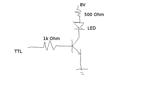

I was trying to drive an LED with a TTL and a transistor circuit. The circuit is set up as shown in the picture. As I turn on the dc voltage, the LED is constantly on instead of pulsing like the TTL. Then I ground the TTL input and weirdly the LED is still on. This is the first time I've learned to use a transistor so I don't know what I did wrong.
p.s. the transistor is a 2N2369A and the TTL is 3V 1kHz and 100ns wide
and the LED is 20mA @ 3.8V forward voltage

If it's not the transistor, then you must have it connected wrong.
your 20mA LED fried the 10mA transistor.
No.
The 500 ohm current-limiting resistor limits the current to (8V - 3.8V)/500 ohms= 8.4mA or a little less due to the saturation voltage loss of the transistor.
I think something else fried the antique transistor, or it is connected backwards.
The basic circuit he posted is sound. As AG and Crutshow said though something is either wrong with the transistor, it's hooked up wrong, or there's something that's being missed about the driving signal.
not connected right
he said he can ground the base and the LED still lights??
he has the connections backwards.
recheck the data sheet and look at the transistor view top or bottom??
more than likely he has the emitter and base crossed.

You need to put a 1k resistor between base and 0v rail to turn the transistor off.
Adding another resistor will not make any difference.
The transistor did not turn off with a TTL low input and when its input was shorted to ground.

The circuit is so simple, it doesn't need to be simulated. It just needs to be repaired, and then to have the input pulse rate reduced below about 30Hz, with a substantial duty cycle, so it can be seen.
Thanks again for all the inputs. I finally found out the problem! The LED which is in a metal box is connected to my circuit through a BNC cable, and the negative of the cable is grounded by the box, which makes the 8V dc to be applied across just the 500 ohm resistor and the led.

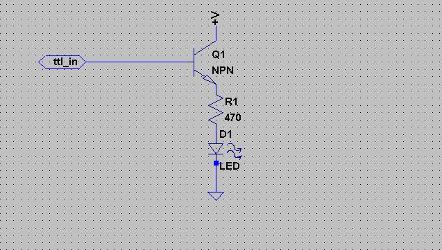

Now that the reason is figured out, I am trying to design a different circuit that does the same job but allows the led to be grounded to the negative of the dc power supply. Any advice will be appreciated.
use the transistor as an emitter follower. there's no gain that way, but it does buffer the TTL output going into the LED.
