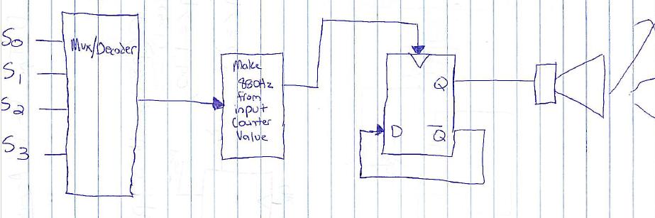

here is my block diagram of how I think it should work. Comments welcomed...

50MHZ/880=56818.18. The I/O on your fpga won't drive a speaker directly.
haha oops. 56818 is the correct counter value. Thx. Brownout. Let me look into the speaker drive. I'm pretty sure I read somewhere that the spartan dev boards has a speaker drive circuit but now I'm not sure.
Make sure you include the headphone jack's connections in your .ucf file. Sure you already knew that :)
