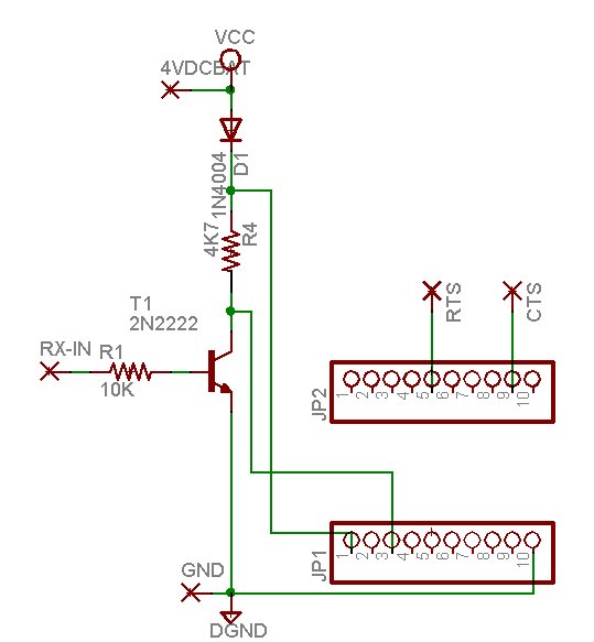

I just received 2 XBee Pro modules. I have a standard RS232 output from a box and it looks like the XBee Pro needs a level converter (3.3vdc yuck) and the signal inverted for the DIN pin.
Does this look like it will work. Being it is wireless I have no idea how I will test it if it does not work. But my first shot.
My device has RTS/CTS as well, I am going to short them on the unit, the XBee-pro will not require it, but I put in pads for that as well.

The fact that it's wireless doesn't change how the level conversion works. Doesn't the voltage need to be regulated? I don't think dropping the extra 0.7V across the diode is going to work too well. I'm not sure about the data rates either, but the pull-up resistor might not allow it to be fast enough (not sure, but just saying).
How did you plan on sending data the other way? I'd just get an level converter IC for that, but usually when I need to convert something I need to convert a whole whack of pins.

The module has a 2.8 - 3.4VDC spec. So I thought I would try that as I have no 3.3 regulator or MAX3232.
The speed is 4800,8,n,1 and one way, so I thought I could get away with this. Once I install my "ideal" diode for protection ;)
You shouldn’t have any issues with RS232, as its non-inverted, just as the example of **broken link removed**
As for the power supply, I wouldn’t lean toward the make-do circuit of yours, 3.3V regs are cheap. Search www.futurlec.com for LM1117T-3
Yea, I saw this one.
The only problem again is a 3.3V regulator (for the remote side). I guess I will delay the project. My 4V battery and diode drop was for the remote station, but I still have the PC side to deal with. I do not want to use a microcontroller on the first project. It is an existing RS232 out to a PC.
